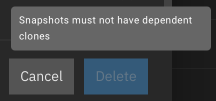

Can't delete snapshots: "must not have dependent clones"

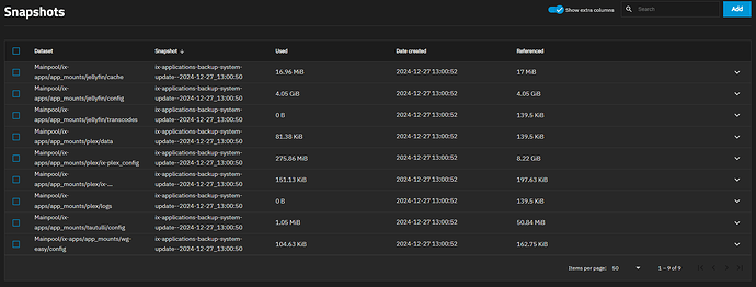

Hello all, i have some snapshots took 2 months ago by the system itself.
I want to get rid of them, but i can’t delete them cause Truenas says they have dependent clones.
i’m assuming they were taken when migrating from core to scale…
how to do?
Thanks

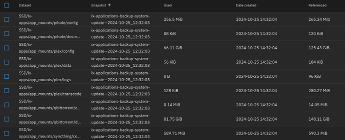

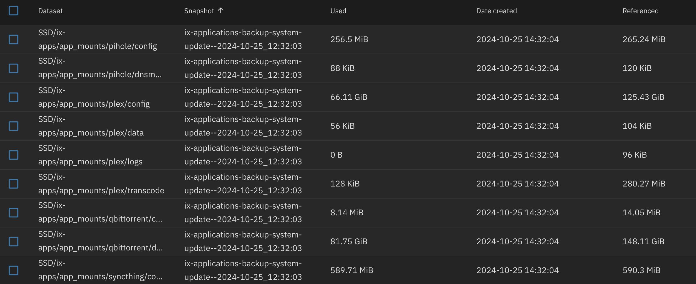

I have just upgraded to fangtooth and i’m still unable to delete old snapshots and get this same message. I have migrated all of my apps, is there any update on this?
I don’t know if other people have the same issue???
These are my snapshots that I cant delete.
Some of those apps I don’t even use anymore or have installed as apps
What do you think?
