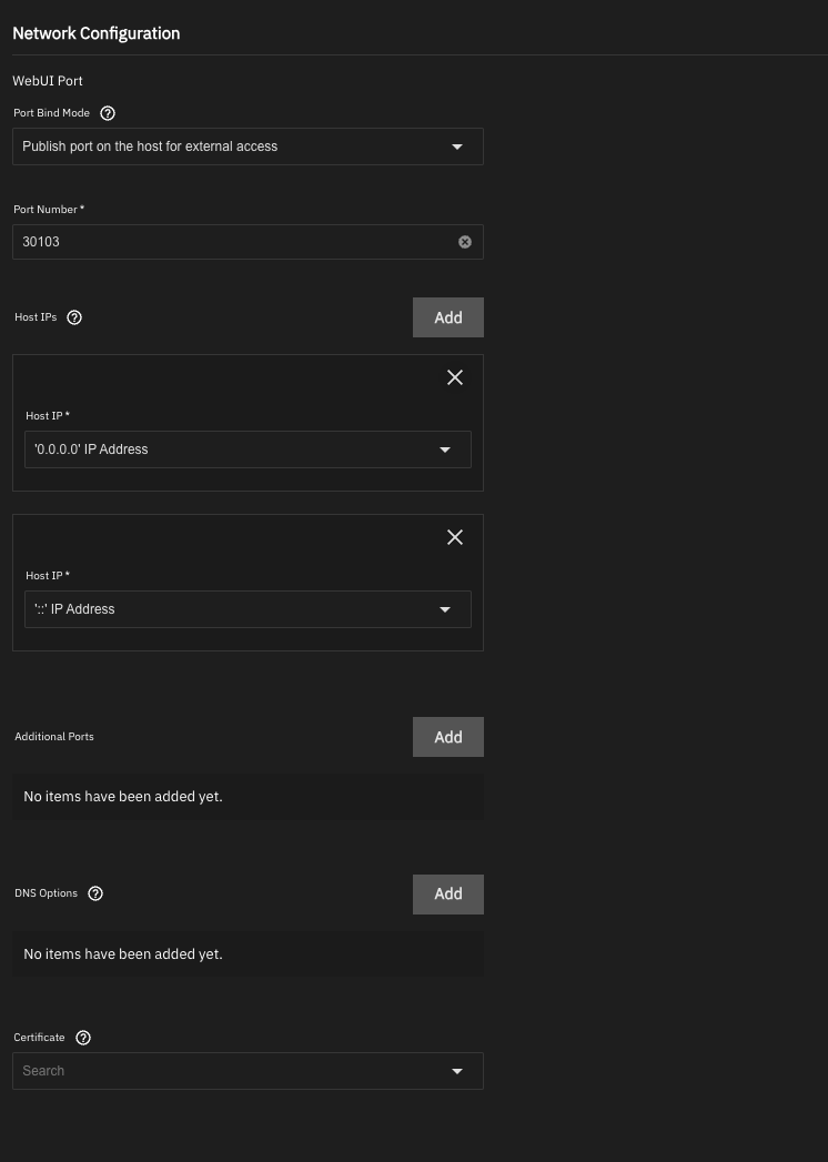

Hello!
I have the same problem…
What should I change in my config to make it discover devices on my network ?
Here my config:
TrueNAS Scale Community 25.04.2.4
NAS IP: 192.168.0.10/24
See in picture my app config.
Thanks!
