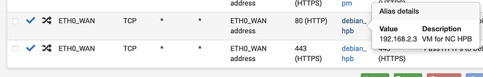

I have a port forward set up for external requests like so:

It looks like I’m getting a 525 error when trying to connect from outside the network, but I don’t know why it’s trying to connect via SSL in the first place.
