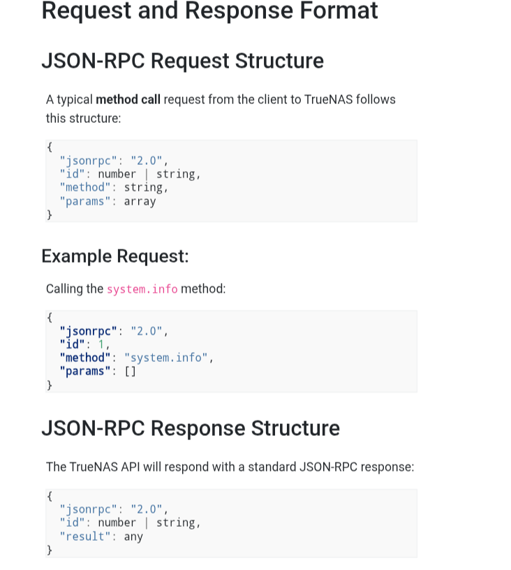

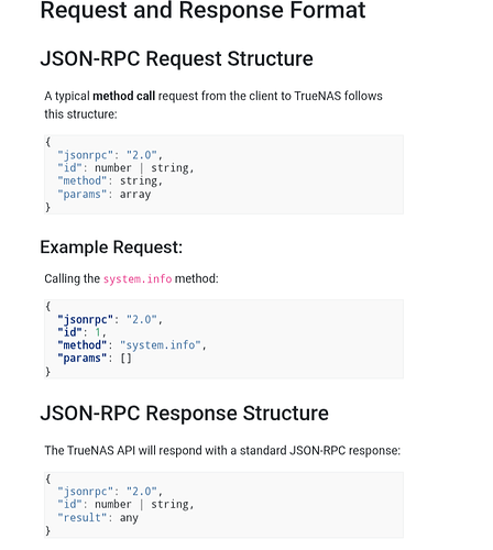

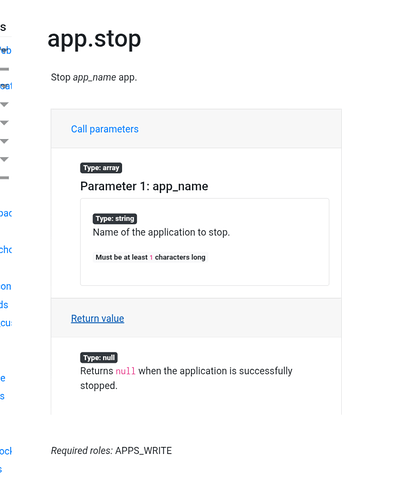

To me, seems that your request is Is not well formatted
Instead of use an array named param you use a JSON containing app_name.
(Just my opinion, don’t use chat gpt without revision at all what he produces )
