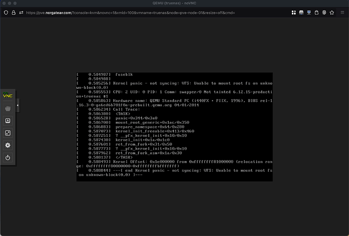

I am struggling to get my system updating to 25.04. I am running the 25.04-RC1 without issues. Whenever I try to update, I get a kernel panic.

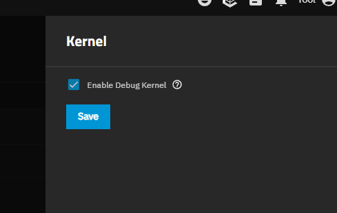

I can, however, reset then and boot into the 25.04 with debugging from GRUB. This works, but is not a solution.
I have also tried with a .upgrade file, doing the update manually. Same result.
Booting back into RC1, deleting the 25.04 boot environment completely and re-applying the update. Same result.

same exact behaviour coming from 24.04 . It also works as you in debug mode.

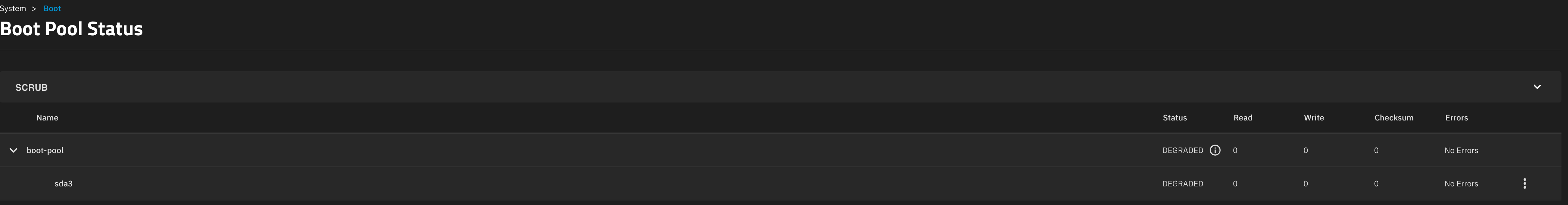

Check of your boot-pool Is Degraded by issuing a sudo zpool status -v
Yeah it is. I don’t know why. And its been like this for a while.
pool: boot-pool
 state: DEGRADED
status: One or more devices has experienced an unrecoverable error.  An
        attempt was made to correct the error.  Applications are unaffected.
   see: https://openzfs.github.io/openzfs-docs/msg/ZFS-8000-9P
  scan: scrub repaired 0B in 00:00:09 with 0 errors on Mon May  5 03:45:11 2025
config:
        boot-pool   DEGRADED     0     0     0
          sda3      DEGRADED     0     0     0  too many errors

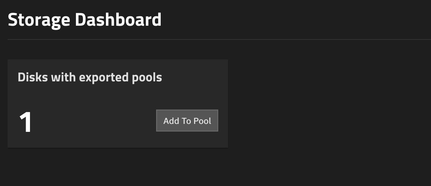

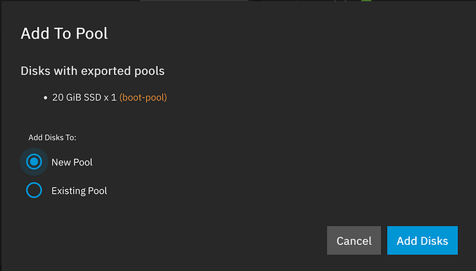

My bool pool also shows as being exported.

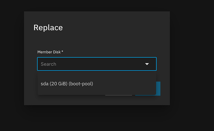

I haven’t tried using the replace. I’m worried it might break stuff even more.
