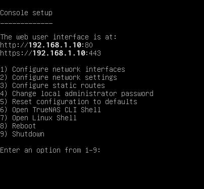

I tried this through the console and not the WebUI “Networks” tab.
You enter an alias for the interface.

23.10 https://www.truenas.com/docs/scale/23.10/gettingstarted/install/consolesetupmenuscale/
24.10 https://www.truenas.com/docs/scale/24.10/gettingstarted/install/consolesetupmenuscale/
In both you enter 1 to configure network interfaces and edit the alias for the interface, just like in the UI process.
Yes, I did so, but AFTER, you pick No1, you cannot add any IP address to the menu.

Then you either select an interface and press Enter or press n to create a new interface. In the Update Network Interface screen for the interface you clear dhcp if needed and then select “aliases” and enter the static IP address for the interface there.
