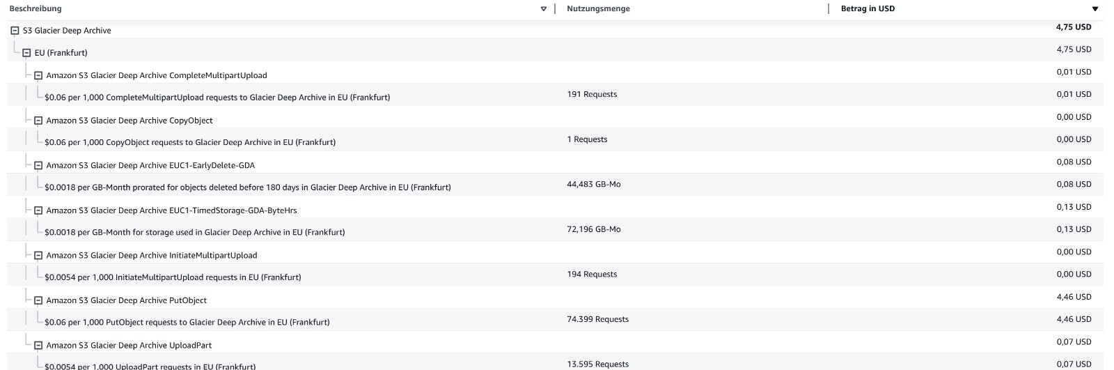

Hallo, a bit offtopic. I am using AWS Cloud directly as for pure archive purposes it seems to be the cheapest option. Also it work quite nice and uncomplicated.
I don’t think it was the cheapest (or the easiest pricing to understand!) when I looked at it, but also I preferred a European provider.
i agree its not the easiest to understand but the cheapest by far. here is an example of mine form last month. most costly is the 1 time bulk upload and in case of recovery the 1 time bulk downliad. incremental uploads are less expensive but the most important thing, the storage itself on deep_glacier is very cheap compared to others.
The larger the files the “cheaper” the uplaod as it charges by PUT/GET Requests. I’ve uploaded approx 75k on Pictures in this example.
