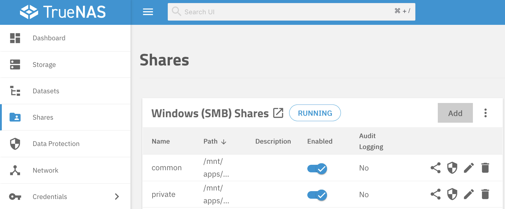

I’m not too familiar with SMB (prefer Unix and NFS…), but I tried setting up a few users and two datasets and shares. (Screenshots are from my test Fangtooth system, if that matters.)

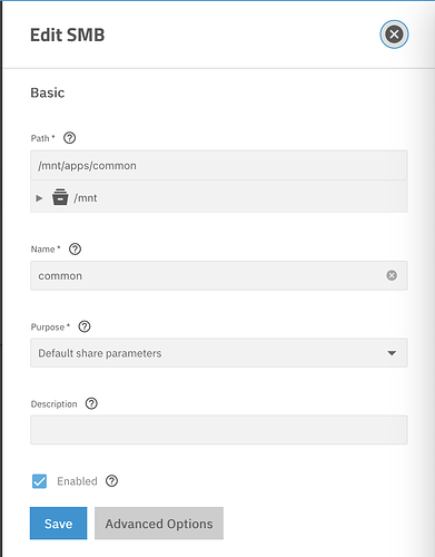

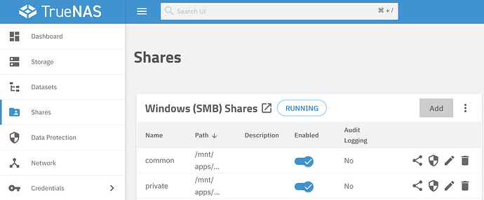

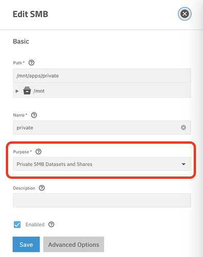

Under Datasets I create two datasets, “common” and “private” and tick the SMB preset; this automatically create corresponding shares.

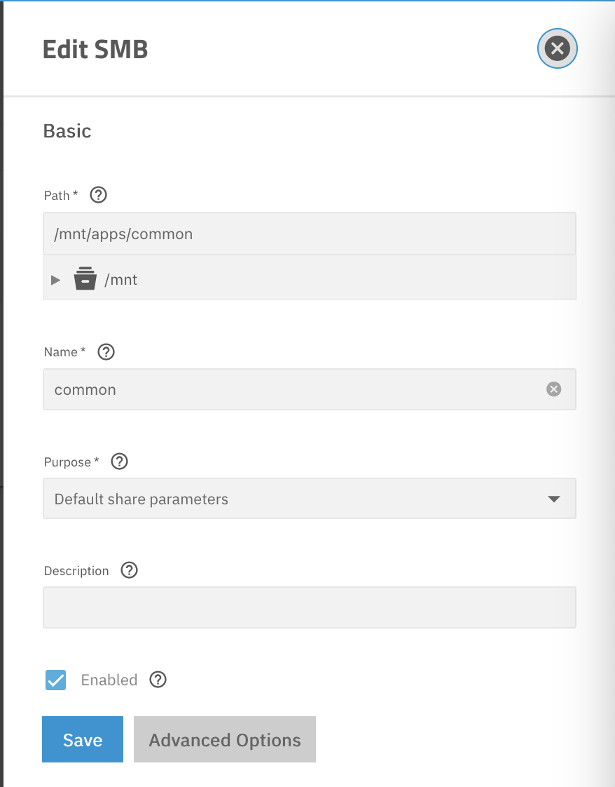

Under Shares, I then click on Edit and leave “common” as a default share, accessible to all,
but set “private” to the “Private SMB Datasets and Shares”

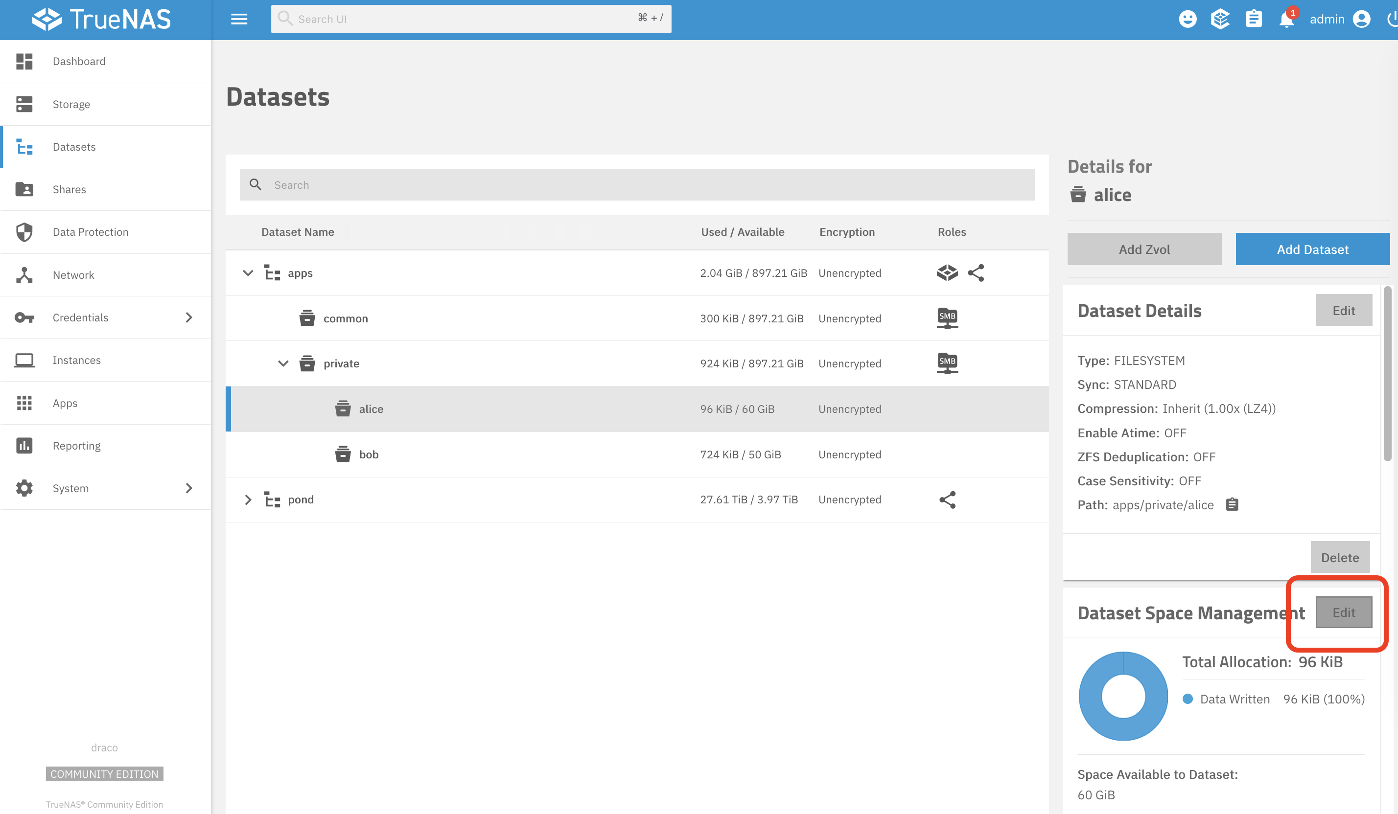

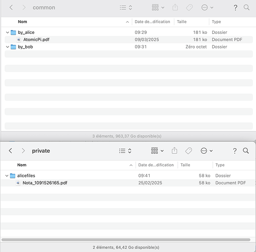

Upon first logging, TrueNAS automatically creates a child dataset in “private” for the user. So I logged as user “alice” and then user “bob”, created folders and copied files unders these personalities.
As administrator, I went back to Datasets to set quotas on the private user datsets of Alice and Bob. (Hopefully, someone can chime in and point to a template system so that user datsets are automatically created with an individual quota and do not require manual adjustment afterwards… I said I’m not familiar with SMB shares.)

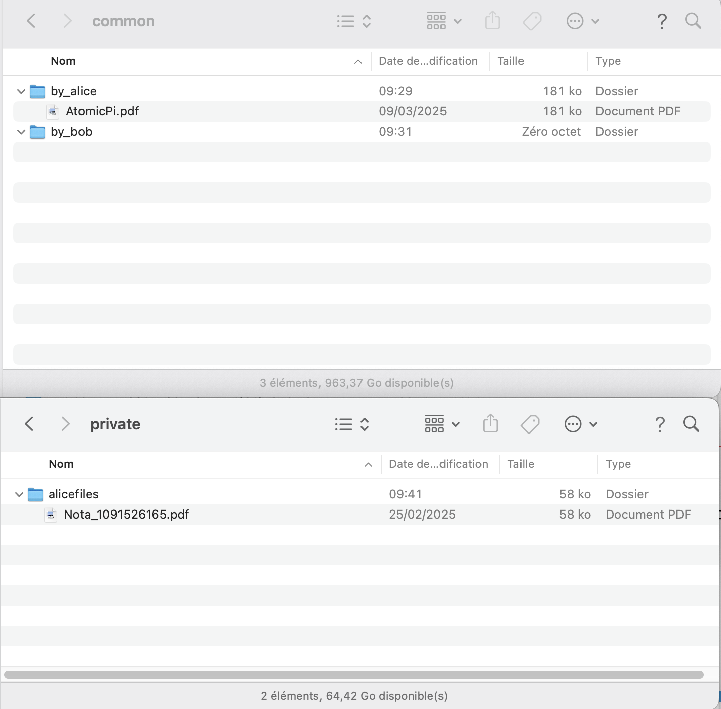

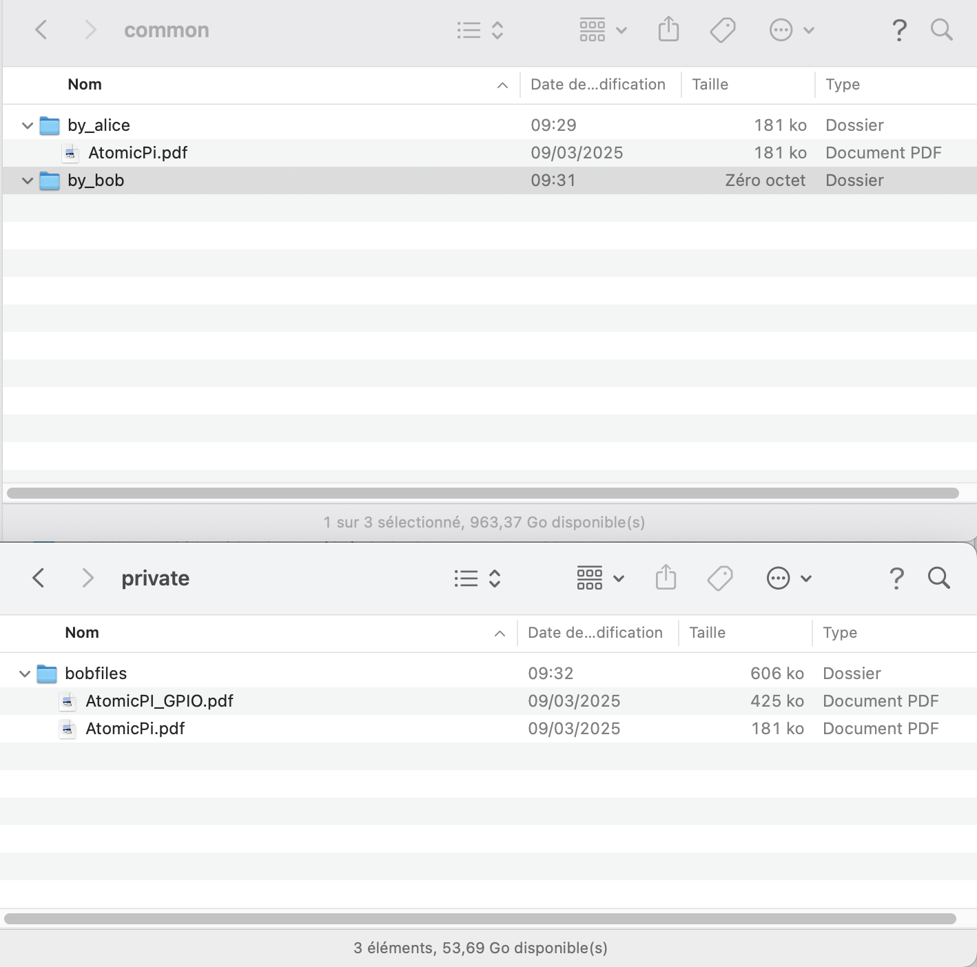

End result: Alice can create folders and copy files into the common share and into her private share. Bob can create folders and copy files into the common share and into his private share. Alice and Bob can see all files and folders in the common share; Bob copied into his private share the file ‘AtomicPi.pdf’ that was first by Alice put into the common share; Alice and Bob each only see their own files in the private share.
Logged in as Alice:
Logged in as Bob:
You can see that “common” potentially has the whole space in this 1 TB pool but that private shares are limited to 60 or 50 GiB.
