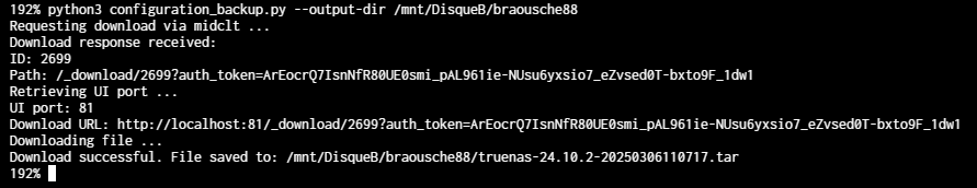

Thought I’d take the opportunity to try and figure out how the WebUI calls the backup job seeing as I could not find any reference to it at all online, this differs to Multi-Report which creates a backup zip from /data/freenas-v1.db and /data/pwenc_secret, same end result though and multi-report has a lot of bells and whistles you should use it for!
python3 configuration_backup.py --output-dir /mnt/tank/dataset/whatever
root@truenas[.../truenas-scripts/configuration-backup]# python3 configuration_backup.py --output-dir /mnt/data/SMB/Backups
Requesting download via midclt ...
Download response received:
Path: /_download/64896?auth_token=<snip>
Retrieving UI port ...
UI port: 81
Download URL: http://localhost:81/_download/64896?auth_token=<snip>
Downloading file ...
Download successful. File saved to: /mnt/data/SMB/Backups/truenas-25.04-BETA.1-20250305222506.tar
Have set up a cronjob for this and it seems to run fine.
0 3 * * * /usr/bin/python3 /mnt/data/bin/truenas-scripts/configuration-backup/configuration_backup.py --output-dir /mnt/data/SMB/Backups > /dev/null
It works very well. The cronjob launched directly too. I will see the schedule tomorrow morning.
