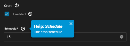

I got some problems with the cron jobs. Nextcloud reporting that it is not running.
At the apps configuration there is a checkbox for “Cron” “enable” and a schedule is required.
Unfortunately, being as unexperienced as I am. What exactly is expected to go in here?
Is “1” a millisecond, second, minute, hour, year?
Is it clock based and “1” is “01:00AM” or something?
The help is of no help and I haven’t found the answer on google.
Maybe somebody can point this out for me.
At least, entering 15 (hoping to be 15 minutes) and checking back on the next day, didn’t change anything in the cron job executings. Nextcloud still reporting that the cron jobs haven’t run since xxxx (since the installation).
Greetings, Alex

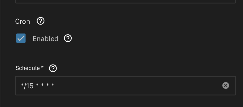

Hello, Probably too late but can help someone from now.
Depending your needs, but In my case I have set to run every the next parameter for every 15 minutes in the Truenas NextCloud App configuration to: */15 * * * *

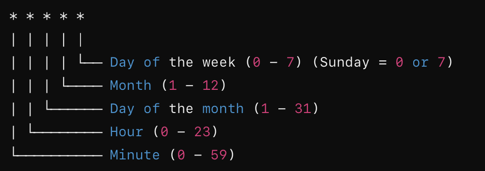

As a side note, the Cron Schedule field requires a cron expression to define when the job should run. It follows the format:
So, you should made your choice based on your needs. Cheers
