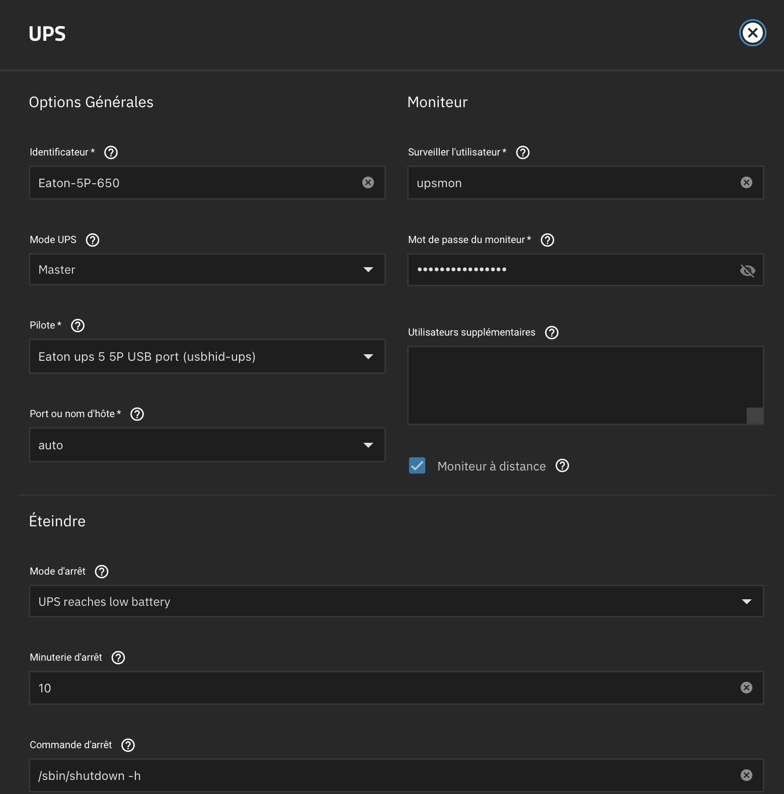

Here is a screenshot from the UPS conf panel:

I also noticed this in the service logs (please note I changed the UPS name in the services menu to “Eaton” so it’s easier for me to query UPS Status with “upsc” cmmand):
root@truenas[/home/admin]# systemctl status nut-server.service
● nut-server.service - Network UPS Tools - power devices information server
     Loaded: loaded (/lib/systemd/system/nut-server.service; enabled; preset: disabled)
     Active: active (running) since Sat 2025-02-08 10:50:03 CET; 11h ago
   Main PID: 2920483 (upsd)
      Tasks: 1 (limit: 76454)
     Memory: 620.0K
        CPU: 57.904s
     CGroup: /system.slice/nut-server.service
             └─2920483 /lib/nut/upsd -F
Feb 08 21:35:03 truenas nut-server[2920483]: Can't connect to UPS [Eaton] (usbhid-ups-Eaton): No such file or directory
Feb 08 21:35:03 truenas upsd[2920483]: Can't connect to UPS [Eaton] (usbhid-ups-Eaton): No such file or directory
Feb 08 21:40:03 truenas nut-server[2920483]: Can't connect to UPS [Eaton] (usbhid-ups-Eaton): No such file or directory
Feb 08 21:40:03 truenas upsd[2920483]: Can't connect to UPS [Eaton] (usbhid-ups-Eaton): No such file or directory
Feb 08 21:45:03 truenas nut-server[2920483]: Can't connect to UPS [Eaton] (usbhid-ups-Eaton): No such file or directory
Feb 08 21:45:03 truenas upsd[2920483]: Can't connect to UPS [Eaton] (usbhid-ups-Eaton): No such file or directory
Feb 08 21:50:03 truenas nut-server[2920483]: Can't connect to UPS [Eaton] (usbhid-ups-Eaton): No such file or directory
Feb 08 21:50:03 truenas upsd[2920483]: Can't connect to UPS [Eaton] (usbhid-ups-Eaton): No such file or directory
Feb 08 21:55:03 truenas nut-server[2920483]: Can't connect to UPS [Eaton] (usbhid-ups-Eaton): No such file or directory
Feb 08 21:55:03 truenas upsd[2920483]: Can't connect to UPS [Eaton] (usbhid-ups-Eaton): No such file or directory
And I also made sure the correct group (nut) has been set to /dev/bus/usb/001/002 (which is the port my UPS is plugged to)
root@truenas[/dev]# ls -l /dev/bus/usb/001
total 0
crw-rw-r-- 1 root root 189, 0 Jan 29 22:02 001
crw-rw-r-- 1 root nut  189, 1 Feb  8 22:08 002
Another hint to what could cause the problem with my UPS :
root@truenas[/home/admin]# upsdrvctl -D start Eaton
Network UPS Tools - UPS driver controller 2.8.0
   0.000000     [D1] Starting UPS: Eaton
Network UPS Tools - Generic HID driver 0.47 (2.8.0)
USB communication driver (libusb 1.0) 0.43
Duplicate driver instance detected (PID file /run/nut/usbhid-ups-Eaton.pid exists)! Terminating other driver!
libusb1: Could not open any HID devices: insufficient permissions on everything
No matching HID UPS found
   6.009493     Driver failed to start (exit status=1)
Does anybody know how I could track down this permission issue?
Thank you
