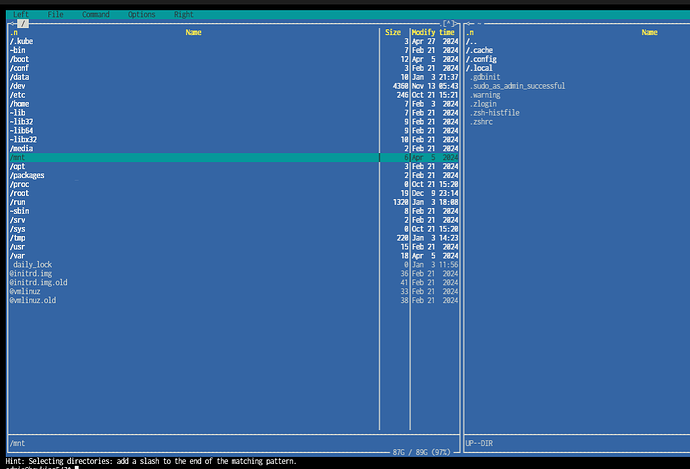

Try logging in into the WebUI of yout TrueNAS server, bavigate to âSystem settings->Shellâ and in the opened terminal type âmcâ (it stands for midnight commander") and press enter. It is a dual panel fiel manager, like Norton commander used to be.
Then navigate on the left panel to your source directory (Usually the pools are under /mnt/) then use TAB to switch focus to the right panel, select the target directory, switch back to the left panel, use F5 tp COPY files and F6 to MOVE files between the panels.

I found MC but I canât find /mnt/ maybe Iâm doing something wrong?

Yes thanks, I could not see /mnt when mc opens but I did File > Quick CD and added /mnt and it then appeared and I could click into it to find all my files. I got stuck assuming that /mnt would be listed when mc opens, or at least would be a sub folder of those locations that are listed. Iâm not a Linux expert as you can guess. Anyway problem solved but useful to know about MC.
