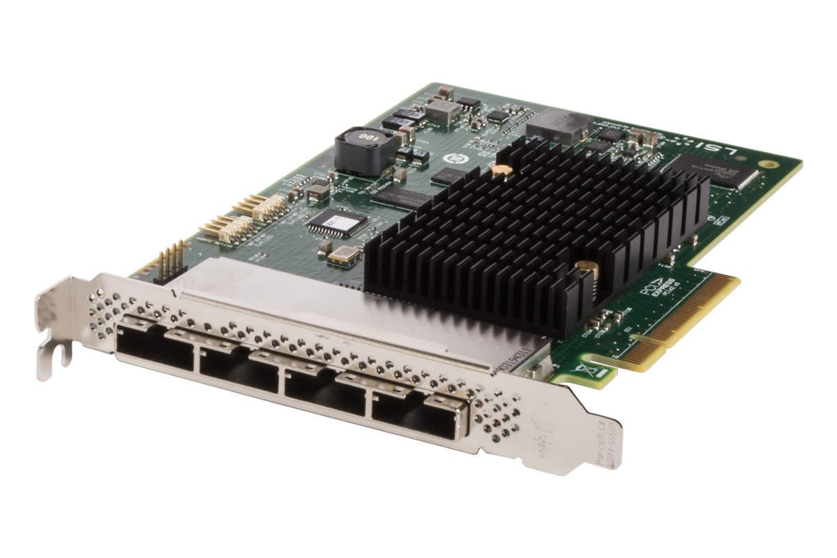

This is what an E card looks like. As you can see it has the ports on the back.

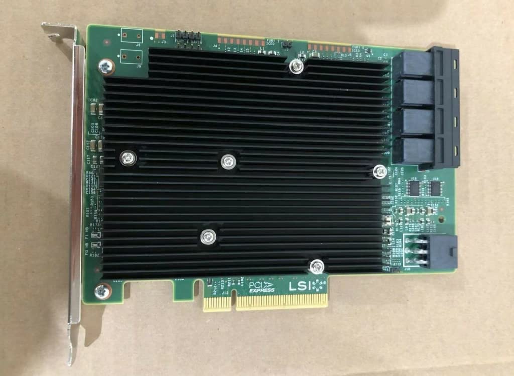

This is what an I card looks like. And it has its ports where they are accessible from inside the case
