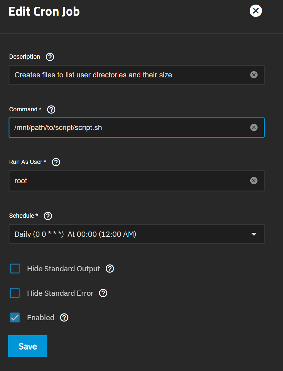

There is a cronjob that was configured to run many versions prior to this update which continues to work with this update. Now after this update, I’ve tried to schedule a cronjob that resides in the /mnt/ path.
It looks something like this:
root@truenas[~]# ls -al /mnt/path/to/script/script.sh
-rwxr-xr-x 1 user1 group1 2078 May 20 12:01 /mnt/path/to/script/script.sh
Running it manually results it working just fine but scheduling it results in the following errors:
May 29 00:00:01 truenas cron[14128]: (root) CMD (/mnt/path/to/script/script.sh)
May 29 00:00:01 truenas cron[14128]: sudo: process 1060311 unexpected status 0x57f
May 29 00:00:01 truenas cron[14128]: Killed
cronjob is running under root and sudo is not involved so not sure why this error pops up. Can’t share the script here but I use the following shebang #!/bin/bash and below is the cronjob config:

just change your command as below :
/bin/bash /mnt/path/to/script/script.sh

@smione that worked. thanks very much. Can you please explain why did this work and adding just the shebang didn’t work?
@awalkerix script just lists directories for each user in descending order based on size.
Mainly due to restrictions from TrueNAS design.
