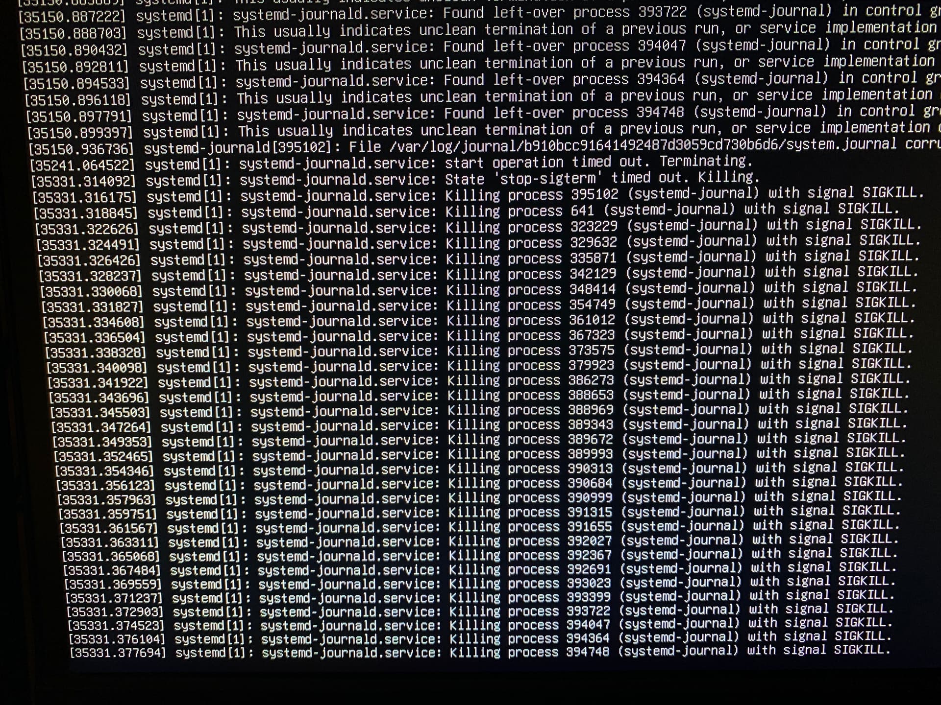

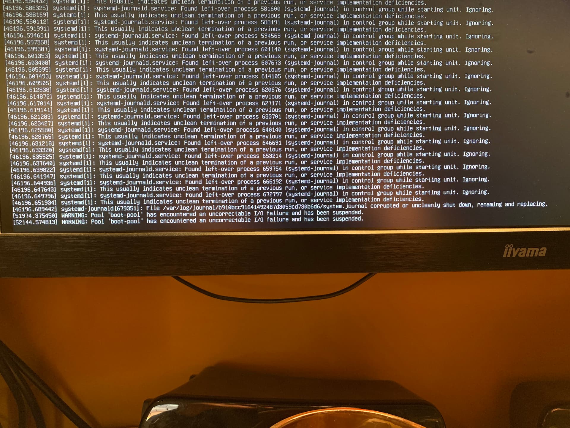

I am having some trouble with my home-built server and I can’t seem to find the problem. My server will run fine for a day and then suddenly crash. For example it can run completely fine for about 10 hours and then stop working while showing the following error messages (see images below for more since I cannot copy paste this):
systemd [1]: systemd-journald.service: Found left-over process (systemd-journal) in control group while starting unit. Ignoring.
systemd [1]: This usually indicates unclean termination of a previous run, or service implementation deficiencies.
systemd-journald: File /var/log/journalsystem.journal corrupted or uncleanly shut down, renaming and replacing.
WARNING: Pool 'boot-pool' has encountered an uncorrectable I/O failure and has been suspended.
