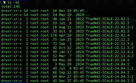

In /var/db/system/configs-<long string of hex> you can find copies sorted by version.
the thing is, how do I access/download them?
I navigate to them in the shell but they do look empty. I’m not sure if I’m doing something wrong
For the future implement @joeschmuck’s Multi Report script and have a backup of your system configuration emailed to you once per week.
I’m not sure why that would be.

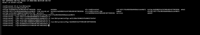

I only have a single config-folder and that contains directories with names like “TrueNAS-SCALE-24.04.2.5”. That in turns contains row of db-files named after the date.
dir1
If your config-directories are empty that suggests they were stored on the now failed boot-pool, maybe? I’m also not sure why you would have three directories.

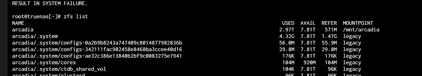

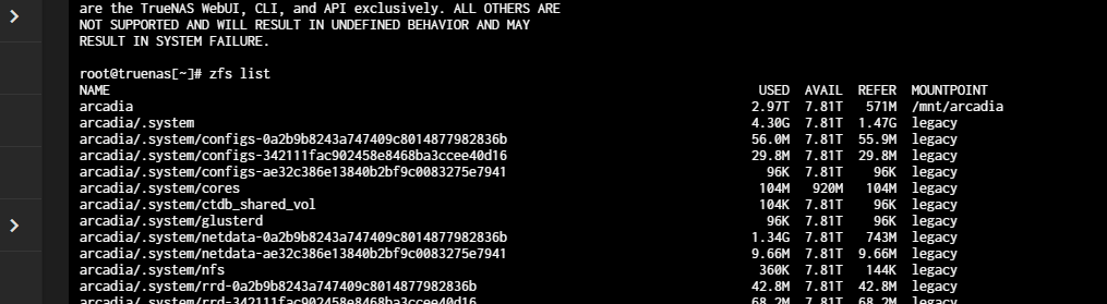

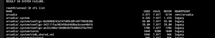

if I go at it with zfs list I get this
so it does look there is something inside those folders? Could I have any chance looking inside the old boot pool with another PC? For whatever reason as soon as I hook up the old boot pool to the server it remains stuck and doesn’t even reach the bios.

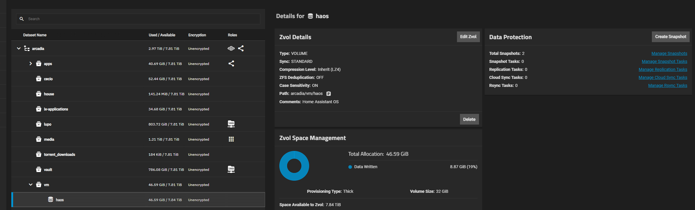

If this doesn’t work, is there any way of linking truenas to the previous zvol of my VM? It does seem to see it in the pool
I suppose it could be that they are not currently mounted in the normal /var/db/system location.

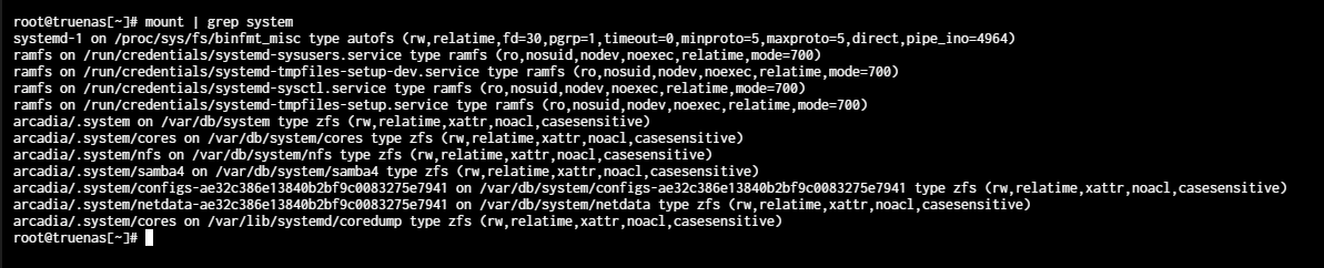

What does mount | grep system show?
not exactly sure what do you mean, but
You previous System Dataset (before the boot drive failure) was probably housed in your boot-pool instead of a storage pool.
Any new configs that get saved will be of your current system. (This won’t be helpful to you.)
So it’s either:
  1. Recover a config db file from the former boot drive
  2. Accept your loss, and next time make it a habit to regularly export your TrueNAS config file
EDIT: My mistake. @neofusion pointed out that the other two datasets are not mounted, and may in fact have recent config files.
Please note that it does not run on TrueNAS 24.10.1 or greater, YET. Email issue is still kicking me in the jewels.
Only the config directory starting with ae is actually mounted at /var/db/system.
The other two, which happen to be the ones with megabytes of contents, are not mounted.
I am in unfamiliar territory and not sure if there are caveats to simply mounting them temporarily yourself to get a db-copy out. Perhaps someone else can say.
Question to more knowledgable here, would these work in this scenario?
mount -F zfs arcadia/.system/configs-0a2b9b8243a747409c8014877982836b
mount -F zfs arcadia/.system/configs-342111fac902458e8468ba3ccee40d16
Do you need to specify the mount point in the command or will it deduce that based on other information?
Edit:
If you need to specify the mountpoint, my uneducated guesses would be these:
mount -F zfs arcadia/.system/configs-0a2b9b8243a747409c8014877982836b /var/db/system/configs-0a2b9b8243a747409c8014877982836b
mount -F zfs arcadia/.system/configs-342111fac902458e8468ba3ccee40d16 /var/db/system/configs-342111fac902458e8468ba3ccee40d16
Edit2:
I should say that I am not so sure about that -F flag. I only see a reference to it that makes sense in the ancient Oracle documentation.
Newer documentation suggests the right flag would be mount -t zfs <source> <mountpoint>. Again, best wait for someone who knows how you actually do this.

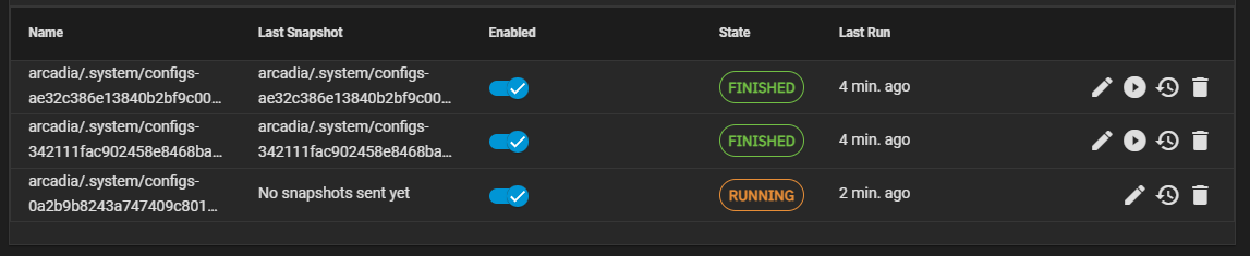

Nevermind?! I did try before posting to run a replication task as I’ve seen someone else suggest in another discussion, but for me it just copied empty folders for some reason.
I tried again just now, and the folders are not empty but they indeed have all the db files and there is one from the 21st of December.
