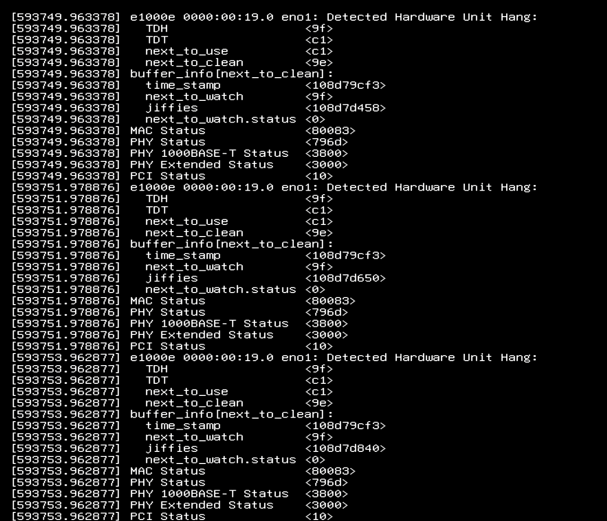

Ever since updating to Fangtooth and setting up my ethernet bridge I’ve had this weird error that happens a couple times a week that leaves my server in an unusable state.
I keep having this error happen.
“eno1: Detected Hardware Unit Hang”

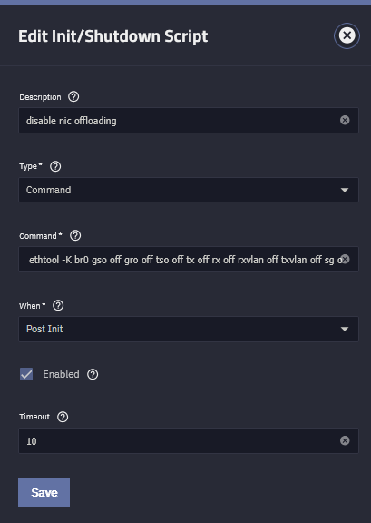

I’ve tried using this but it doesn’t seem to fix the solution, only delay the time it takes for my server to crash. I configured it as an init script

What hardware is this running on, and it is running bare metal or virtualised?
Bare metal, and it’s running on a GA-X99-UD4.

I have a small NAS that has been using TrueNAS scale for over a year now. It had been operating without issues for that entire duration. After upgrade to Fangtooth I setup a VM for an Ubuntu host for Minecraft for my kids. I also had a pre-existing Plex App setup that was working fine. We started to notice that we would lose network connectivity to the TrueNAS host. Initially I thought it was a bad network wire as unplugging and replugging in the network cable would resolve the issue. The issue remained after swapping network cables and even trying different ports on the switch as well as a different switch. I finally broke down and connected a monitor and keyboard to the host (which was running headless) and saw a stream of errors identical to those from the OP. What was interesting is that while the errors were showing up every few seconds, the moment I unplugged the network cable, the error stopped and when I plugged it back in, the system was available! This is some type of hang state that resolves itself when the connection is interrupted.

I don’t think this is something like a cooling issue (as the same setup worked fine for months and prior to Fangtooth upgrade). Especially as I can get it out of the hang state by just unplugging the cable from the adapter. I believe this is something in Fangtooth (likely the underlying Intel NIC driver?) that is causing this.
