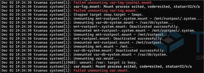

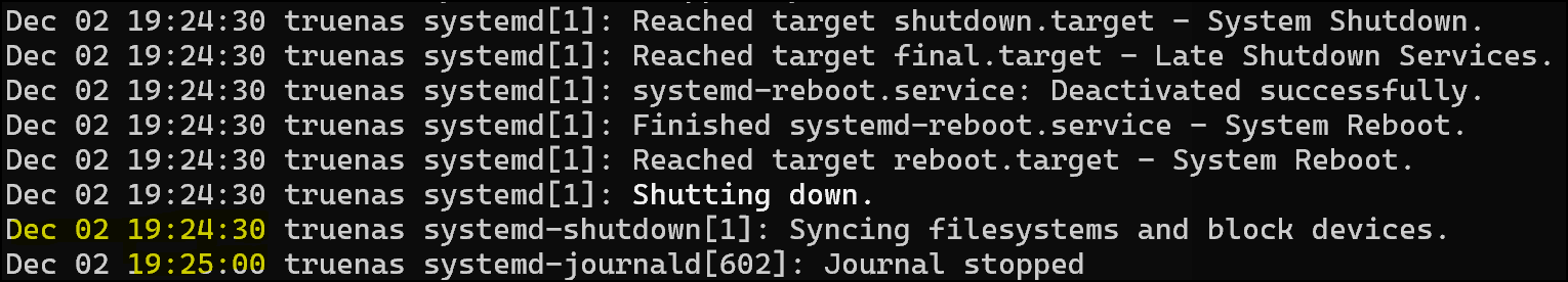

What’s going on during the next 30 seconds? This is the tail-end of the journal just before lights-out.
I’m wondering if this is related… This happens on every shutdown:

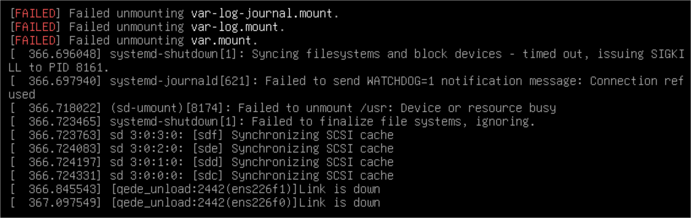

Also managed to screenshot this just after a hang and before a reboot (only displayed for a fraction of a second):
One more data point… A user-initiated sync usually runs/exits immediately but sometimes takes 30 seconds to exit. Happens at random. I suspect it’s related to my slow shutdowns if systemd is having to SIGKILL it…
The error messages you had, I get those as well and I have seen others who get those. I would not worry about those unless you find out you are having corruption issues. I have not noticed any at all.

Seems to me that a timeout of 30s for the filesystems to sync and unmount timed out.
That seems to be logged.
