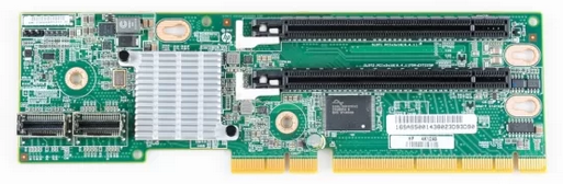

Once completed you COULD migrate the complete contents to another pool. If you’re really smart you will use an HP or DELL server with hot swap capability and I would recommend against using GIGANTIC drives as in RAIDZ2 you loose the space of two drives. I have Six 4T drives in my system for media. I’ve used it a lot and have as much free space as used. So there’s little danger of running out of space.
The HP DL380eG8 14LFF is what I recommend. Gives you lots of options. Install a 320i riser card to get pass through on drives, and let TrueNAS do it’s thing with RAID.
One reporter’s recommendation.
riser_HBA
DO NOT use hardware RAID with TrueNAS.
