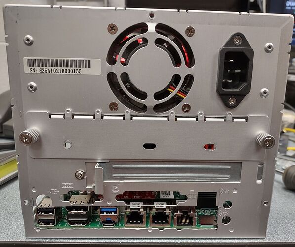

Decided I would go ahead and toss my latest DIY build in here. My goal was to build something that draws less power, makes less noise, and makes less heat than my DL360e Gen8 with 8 spinning drives.
Started with an old case I had around:
Testing to make sure everything works
And final images
Still some work to do, need shorter SATA cables and maybe change the case fan and the fans in the 4 bay Icy Dock.
Mainboard is Topton n100 with 2.5gbps and 10gbps (n18 model)
16GB of ram
Silver Stone power supply (tight fit)
Two recycled emmc from a couple HP T740
Six old 1TB spinning drives (want to change to SSD but money makes this wait)
Truenas Electric Eel (24.10.0.2)
Only needed about 3-4TB useable for my lab so kind of a budget build. The stuff I had to buy brings this up to about $500usd. If I added nvme and SSD drives, price would go up another $300 to $400 depending on the parts selected.

Makes me wish I hadn’t of chucked out an old Shuttle XPC 58 case a few years back :wink:
Did you achieve your goal? I would imagine you are drawing less power, but what about the noise? The case rear fan looks like a high static pressure fan (spins really fast and is loud).
Good for you on reusing parts you had. It is always a good less expensive way to build something. You can replace those drives as time permits, and since they are 1TB, you could easily replace them with 2TB SSDs, one at a time. However you stated:
Which makes me thing you created a STRIPE for a pool. That means a one for one drive swap is not possible without losing the entire pool. Just something to think about if you are using a STRIPE.
I like that you took the time to tie the cabling in place, too many people just don’t care about it.
Shuttle used to make some neat products, glad I didn’t trash this years ago.
The loudest parts are the small fans in the 4 bay drive adapter, I had that around from like 15 years ago and think I could reduce the noise with modern fans. The case fan is more quiet than I thought, at least at idle. I’ll probably replace it just because it’s 24 years old and had a hard life back when I was editing video and encoding the DVD.
I don’t have a plug in power meter, but even with the spinning drives, it has to be under 100 watts. The idle heat output suggests significantly under 100 watts.
I built a RAIDz1 pool with all 6 drives (1TB each) which gave me a little over 4TB to use. I may go back and wipe everything and go up to RAIDz2, those drives spent about 7 years in a NAS at work before I replaced them, chances are good that I’ll have failures.

Cleaned it up a little:
Much nicer with the slim and shorter cables. Bought a cheap watt meter, 46 watts while booting, sitting at 33 watts idle, a third of what the rack mount server is running at idle. I wonder how much of a drop I’d get from SSD, idle might not be much, but I’d guess that running could be lower.
