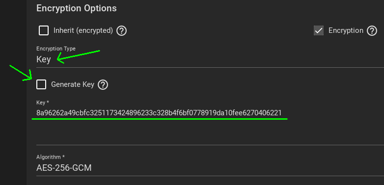

When you go to create a new dataset with encryption, did you notice you can input your own 64-character hex string, rather than have one auto generated?
You know what else is comprised of 64 hex characters? A SHA256 hash.
Are you starting to get it?
What happens if you lose your dataset’s keyfile? :flushed:
You forgot to export it? :open_mouth:
You forgot where you saved it? :scream:

Benefits:
  • Losing the keyfile doesn’t mean you lost access to your encrypted data. As long as you still have the original photo, you can regenerate the key.
  • You don’t need to memorize a passphrase.
  • You technically don’t even need to save your actual key anywhere. No one will suspect that a particular photo’s SHA256 hash is your key.
  • It’s fully compatible with ZFS and TrueNAS. It does not require you to change any other data protection habits, such as exporting and saving your encryption keys the traditional way. (You can do both.)
Cons:
  • None.
Caveats:
  • You obviously need access to the photo. Don’t have the only copy of this file saved within the encrypted dataset itself. (Duh.)
  • Do not edit or modify the original photo. This will alter its SHA256 hash.
