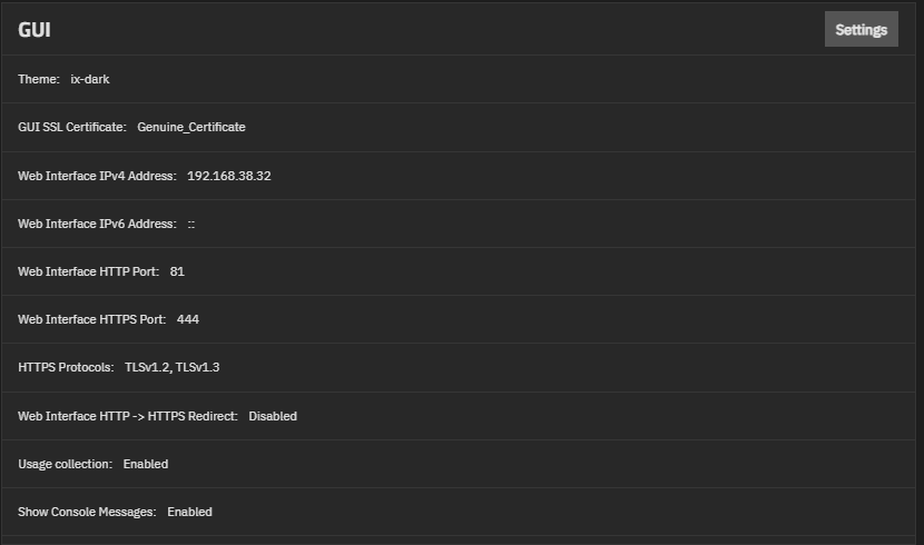

TrueNAS on 81/444 bound only to 192.168.38.32
nginx on 80/443/30030 bound to 192.168.38.201
Trying to rest the TN GUI to 80/443 brings up an error saying ports in use

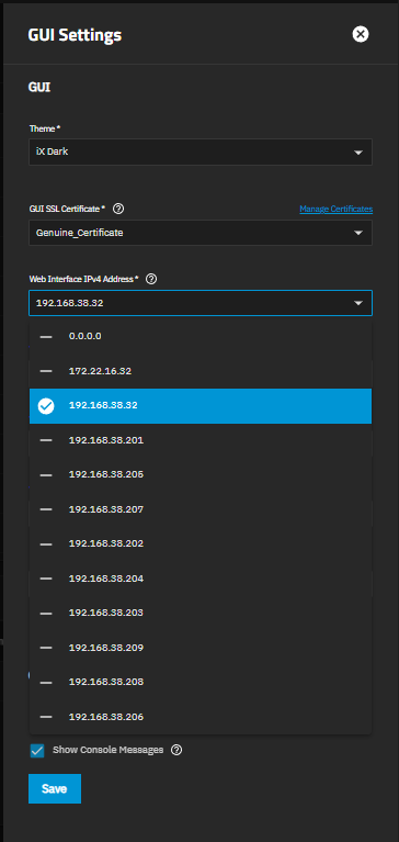

Have you made sure that the WebUI service is not listening to the 0.0.0.0 address too? Make sure to check “Web Interface IPv4 Address” under GUI settings again. Without listening to 0.0.0.0 it was possible for me to bind my custom docker app to port 80 of the second host IP i added using TrueNAS 25.04.1 and latest catalog version 1.2.3.
But I still have issues when trying to bind port 22 of a docker container to a single IP. It fails with The port is being used by following services: 1) "0.0.0.0:22" used by SSH Service and i cannot find a configuration setting to change the listening/bind address of the service.
@harryw I am certain the TrueNAS is bound to a single port only and not 0.0.0.0

These are my GUI settings
(for the record)

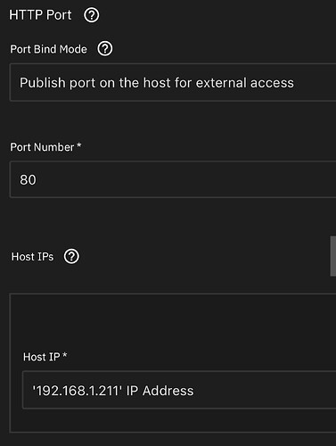

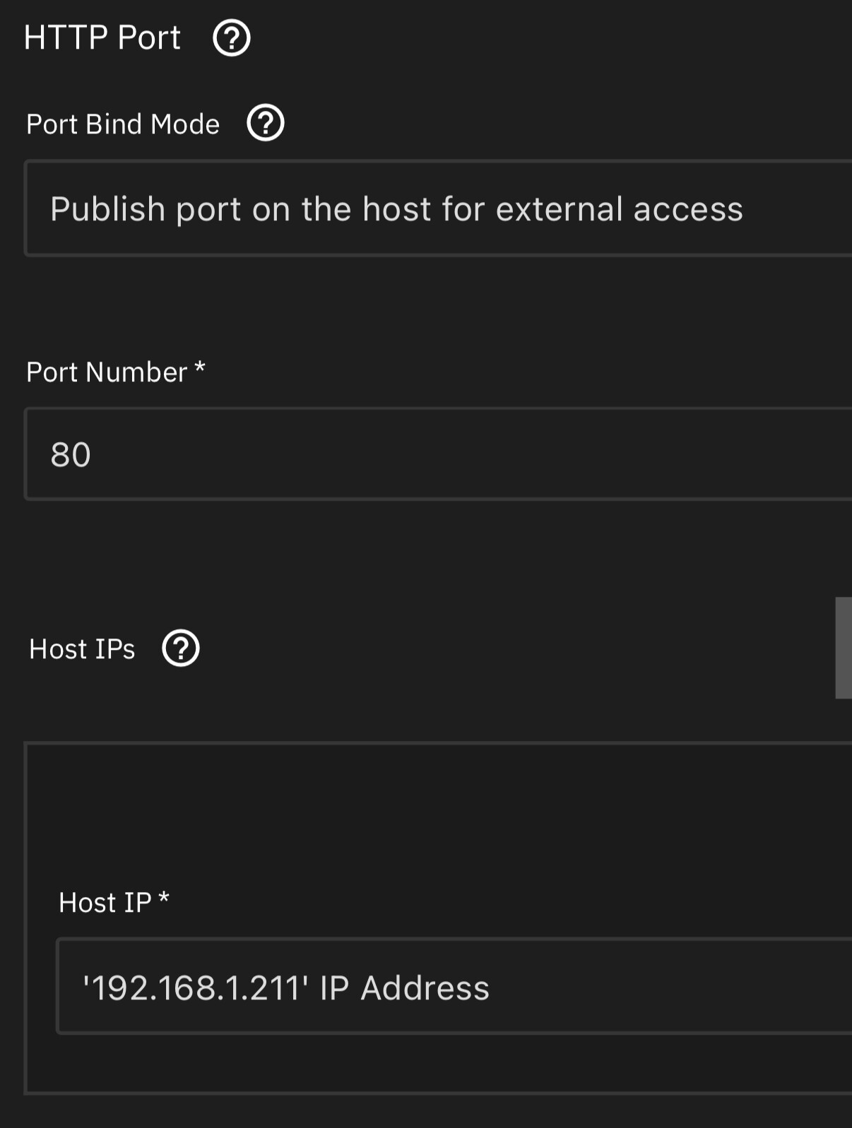

Can you not just change it in the app settings?
I checked the app. It allows ip binding on all three ports (web ui, http and https).
Make sure you do.
Apparently I am an idiot.
I changed the IP binding on one of the ports and never spotted the same on the others. I never considered that once I had changed the IP address for the container that I might have to do that twice more.
