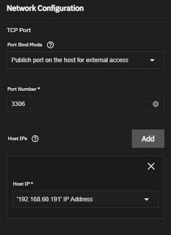

This is what it looks like for mariadb right now, in the GUI:
There are workarounds as mentioned, but this is much more native support, closer to what I would expect, coming from Core 13. I don’t know if you can pick the same IP over and over for all your apps as some have requested. Doesn’t make sense to me but I’m sure there are valid reasons. One app, one address, keeps it simple on my LAN.
