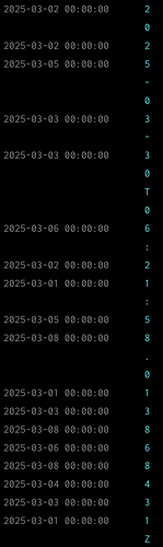

Now that I’ve upgraded to new version, going into Container logs all I see is the following:
2024-11-02 00:00:002
0
2024-11-04 00:00:004
2024-11-01 00:00:001
0
T
0
0
0
2024-11-06 00:00:006
2024-11-09 00:00:009
0
2024-11-03 00:00:003
0
2024-11-08 00:00:008
Z
which doesn’t look correct.
How can I fix this? Thank you

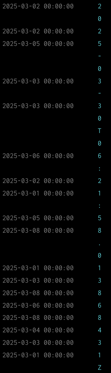

It looks like the UI cannot render the timestamp of the logs correctly
I’ve seen it do the vertical thing too in one app, forgot which one.
The solution is to disable TTY in the app settings.
With TTY enabled the log is not working in the UI
It is not planned in near future to fix this
