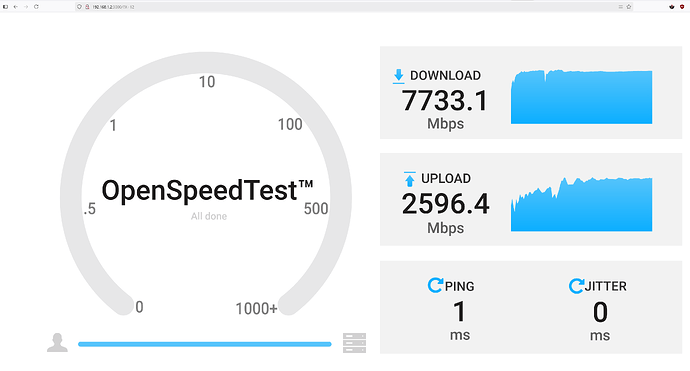

I came from here:
because my OpenSpeedTest docker container does not reach full speed with 10gbits.
i tried to set MTU for vb-docker in Network settings, but seems like there are two of those… docker Network interfaces.
root@NAS[/lib/systemd/system]# ip a | grep mtu
3329: vethfd0996c@if3328: <BROADCAST,MULTICAST,UP,LOWER_UP> mtu 9000 qdisc noqueue master br-e78bd1299d8e state UP group default
1: lo: <LOOPBACK,UP,LOWER_UP> mtu 65536 xdpgeneric/id:5209 qdisc noqueue state UNKNOWN group default qlen 1000
2: enp6s0: <NO-CARRIER,BROADCAST,MULTICAST,UP> mtu 1500 qdisc mq master br1 state DOWN group default qlen 1000
3: enp7s0: <NO-CARRIER,BROADCAST,MULTICAST,UP> mtu 1500 qdisc mq master br1 state DOWN group default qlen 1000
4: enp8s0: <BROADCAST,MULTICAST,UP,LOWER_UP> mtu 9000 qdisc mq master br1 state UP group default qlen 1000
5: br1: <BROADCAST,MULTICAST,UP,LOWER_UP> mtu 9000 qdisc noqueue state UP group default qlen 1000
8: vnet0: <BROADCAST,MULTICAST,UP,LOWER_UP> mtu 1500 qdisc noqueue master br1 state UNKNOWN group default qlen 1000
3198: docker0: <NO-CARRIER,BROADCAST,MULTICAST,UP> mtu 1500 qdisc noqueue state DOWN group default
133: vb-docker@if2: <BROADCAST,MULTICAST,UP,LOWER_UP> mtu 9000 qdisc noqueue state UP group default qlen 1000
Still stuck at 1500 instead of 9000
