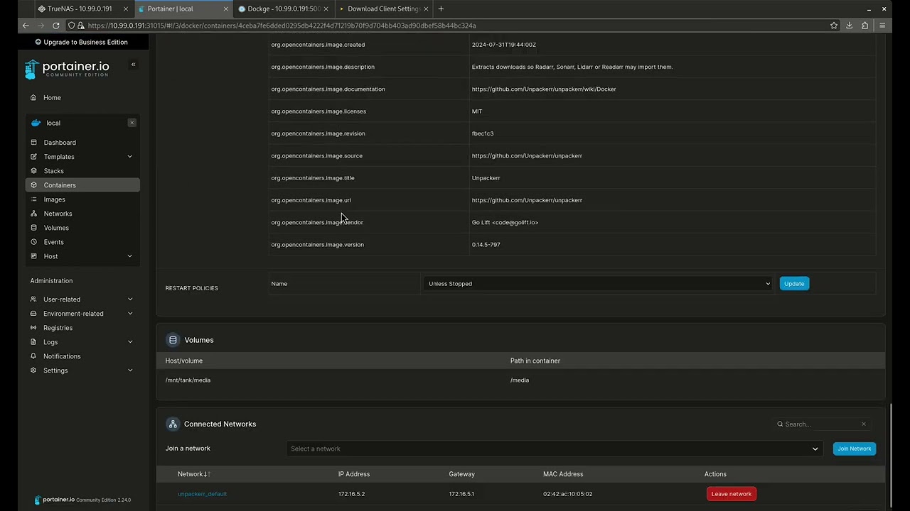

this highlights the networking in dockge which you should be aware of. oddly enuff he is using portainer to setup network, but dockge to deploy apps. becauz dockge networking still isn’t working properly yet in ui :grimacing:
