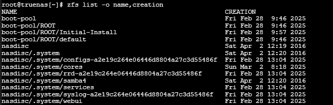

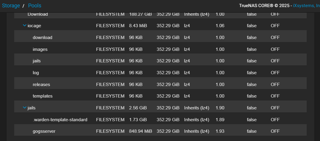

Im wonderig if I can remove all “jails” and “iocage” datasets from picture:
Can I do ? Im not sure if this is from “old” system (FreeNas) or belongs to “new” system (TrueNas) and I should remove it.
Im going to cleanup datasets if this is not needed.

ok. I asked about GPT4 support and received a sufficient respond. I removed all jails and iocage patrs from data sets. I removed also some old datasets. Now my pool looks like fresh installed.
I suppose above datasets are necessary becase have actual date time (I cut out my known)
