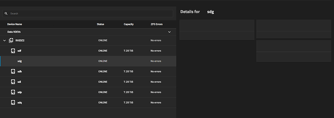

Does this VDEV include this disk or not?

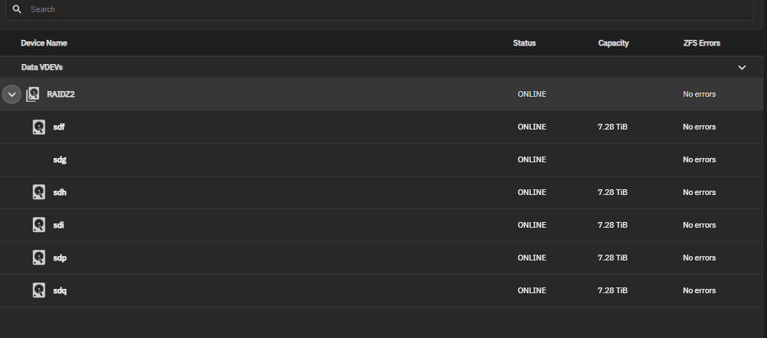

Can anyone help me understand/fix this? Recently migrated a running system from Core to Scale. I had this 6-disk VDEV in core, raidz2.
When i started Scale, disk sdg was shows as here in this image - but it ALSO showed as online in a different pool. I detached form the other pool, so no screenshot, but i do not show unassigned disks nor do i see any status for this disk in this pool.
I have NO IDEA what is going on.

PS i know i have a degraded pool - i moved recently and lost 2 disks, swapped in my backups, then two more failed (lucky timing!) and i am still waiting on the replacements to arrive, while i sweat bullets waiting for another disk to fail. Needless to say, more spare disks on hand from now on.
Based on that information, I’d say the issue for “sdg” is in the GUI. Nothing to be concerned about for the “earth” pool.
As a side note, I’d run the scrubs a bit more often. At least once a month. Others run scrubs every 2 weeks. Pool “earth” had it’s last scrub on May 25th.
