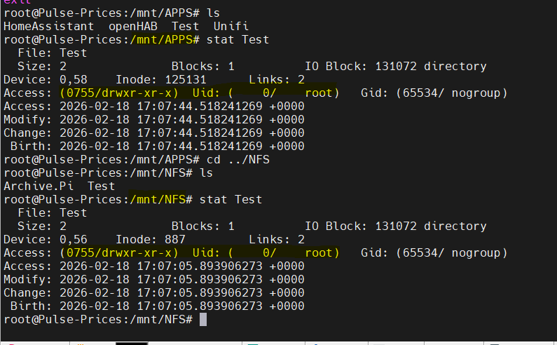

As root, I can see folders on both Shares, but can only access folders, which have Other permissions.
Stat Folder, shows 65534 (Nobody) & 65534 (nogroup) permissions.
As non-root, I can only see folders in ONE Share. The visible folder does not have sufficient permissions to access it…. No Other permissions.

Well, it seems that my LXC root user does have write permissions to both Datasets mapped…
I can create folder(s) in both Datasets……
I guess I’ll need to do transfers as root, or revert back to root as primary user.
