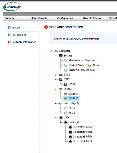

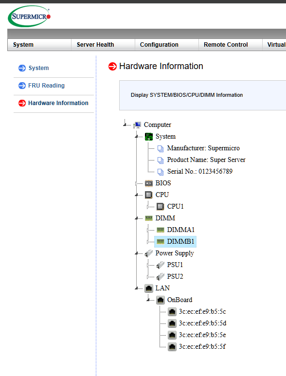

Take a look in the IPMI and see what’s reported in there. This should at least indicate whether the board is detecting the ECC functions correctly.
System > Component Info > Memory

There are no details whatsoever that the IPMI gives
