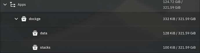

Thanks! I didn’t understand the syntax for volumes when i wrote those composes. even with that mistake though, the thing i downloaded did end up somewhere on my system. i’d like to know where that is since it’ll help me learn and troubleshoot this.
i’ve actually tried two different installs of dockge. the first time, i had truenas create ixvolumes for data and stacks, and i couldn’t find where they were at all. i also did a similar bittorrent setup to the one i posted above, and couldn’'t find the test file i downloaded.
i then uninstalled dockge, created data and stacks datasets as suggested in this video, and then reinstalled dockage set to use them instead. i then did the Compose i posted, and did another test download. i can see some small config files in the Data and Stacks datasets, but not the file i downloaded. also, my data and stacks datasets only have ~330 KB in them combined, so i don’t think they contain the gluetun and qbittorrent installs from that Compose either.
Sorry that this is imprecise, and thanks for the reply.

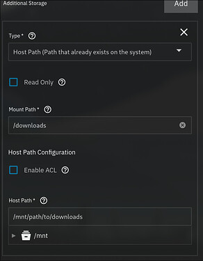

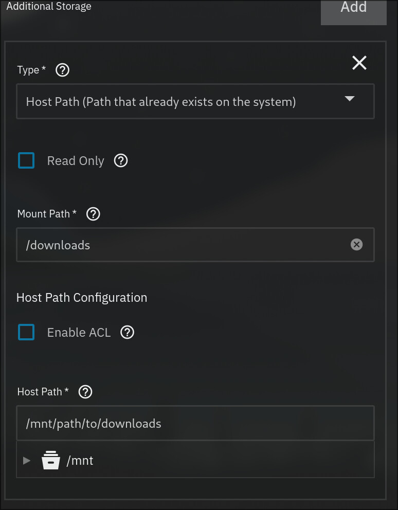

so, this is … somewhere. long term, i want to mount a 'downloads" folder in a different dataset to this location, so downloads go to a folder i can access without the command line. i assume i need to grant dockge access to that location by adding additional storage. Does this look right?
And do i need to change the docker compose as well?
No, you modify the compose file
volumes:
      - /mnt/YOURPOOLNAME/docker/qbittorrent:/config
      - /mnt/YOURPOOLNAME/downloads:/downloads
Then you click deploy.
this is assume you that you created a docker/qbittorrent dataset on your pool, and also a downloads dataset/directory

i haven’t created a /qbittorrent dataset. the only new one’s i’ve made for this were the three in my earlier screenshot
/mnt/Apps/dockge
/mnt/Apps/dockge/data
/mnt/apps/dockge/stacks
i don’t quite follow where you want me to create that /qbittorrent dataset. your example has it under a /docker dataset, which i currently don’t have. i’m not sure if that was a typo and you meant /dockge, or if i also need to create a parent /docker dataset for /qbittorrent. which of the following are you telling me to create?
