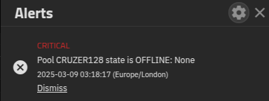

The next email at 03:18:
TrueNAS @ truenas
New alert:
Pool CRUZER128 state is OFFLINE: None
The following alert has been cleared:
Pool CRUZER128 state is ONLINE: One or more devices has experienced an error resulting in data corruption. Applications may be affected.

Since it says CRUZER128 went offline and you aren’t using it, I would remove the USB drive and see if the problem returns.
I agree - done:
Successfully exported/disconnected CRUZER128. All data on that pool was destroyed
I hope to find out what caused the crash & reboot. I’d presume that a simple USB stick failure (in some manner) shouldn’t have taken the whole TrueNAS appliance with it, so I presume there’s another cause which either upset the USB stick and also caused a reboot, or the USB stick aspect is a coincidence (which seems unlikely).
Nah, it shouldn’t take down the whole system, but it’s unclear what the problem was. I don’t know if there’s some sort of odd hardware failure with it that could have caused a kernel panic.
The error could be the result of something else that caused the reboot.
Still, I’d start with removing unused hardware :slight_smile: Hopefully resolves it, and if not we’ll have it ruled out…
