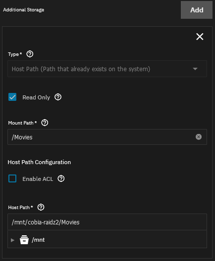

Can you show a screenshot of your “Additional Storage” setting in the Apps screen, such as shown below?
Jellyfin would not start when I changed these.
For some reason I can’t include a screenshot in a post.
Type
SMB/CIFS
Mount Path
/MEDIA
SMB Configuration
Server
LFTrueNAS.local
Path
Media
Are you doing a loopback SMB mount such that LFTrueNAS.local is the system that the SMB share is running on as well as Jellyfin?
Yes, this is all on the same server.
Is there a particular reason you aren’t using host paths? Adding SMB introduces many more potential failure points, including my favorite one of “DNS does something silly and won’t resolve the SMB servername you’re trying to mount”
If you open the Volume Mounts or container shell (from the Apps page) do you see the contents of your folder if you ls /MEDIA?
I had initially set it up using host paths, but jellyfin did not see any media.
I just reconfigured jellyfin to use host path instead and get the same error.
I finally figured out what you meant by running ls /MEDIA from container shell.
When I ran it I got this:
OCI runtime exec failed: exec failed: unable to start container process: exec: “ls /MEDIA”: stat ls /MEDIA: no such file or directory: unknown
