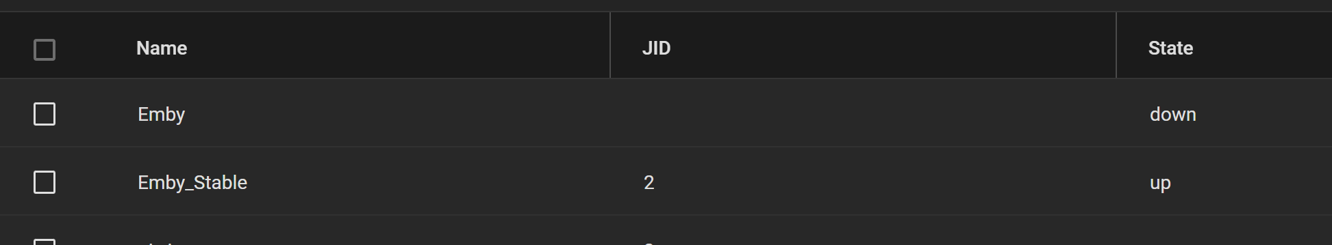

ha ha I started trying this- I created a blank jail, called ‘Emby’, then set the block setting.
Then, for fun, I rebooted - and my NEW jail failed to start, whereas my Emby_Stable jail started automaticaly - for the first time in 2 years.
I wonder if this is a Jail issue, not a plugin issue?
Is the auto start box ticked?
yes. It’s strange.
And I assume the IPs are different?
Are you using a VNET jail?
yes, and yes.
I think this is just some startup something-not-ready
I tried enabling Netwait, but no change.
I think I just need to accept it, and manually start it every time :slight_smile:
You can start it manually though, can’t you?
