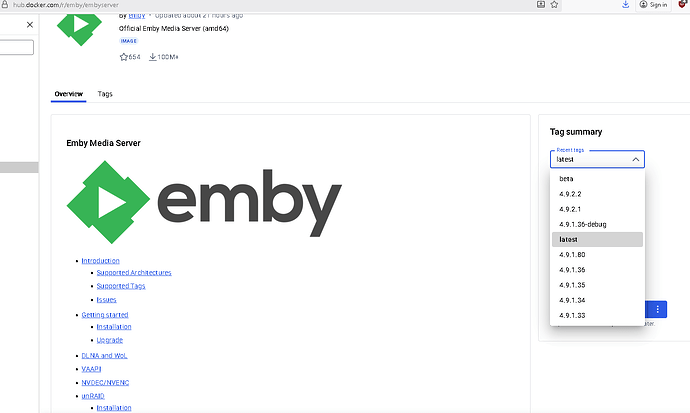

From https://hub.docker.com/r/emby/embyserver
The only difference in Docker commands is
Pulls LATEST
docker pull emby/embyserver
Pulls the BETA
docker pull emby/embyserver:beta

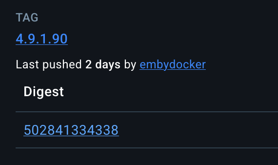

Ok , just push that 4.9.1.90 which is stable and will never update again!
