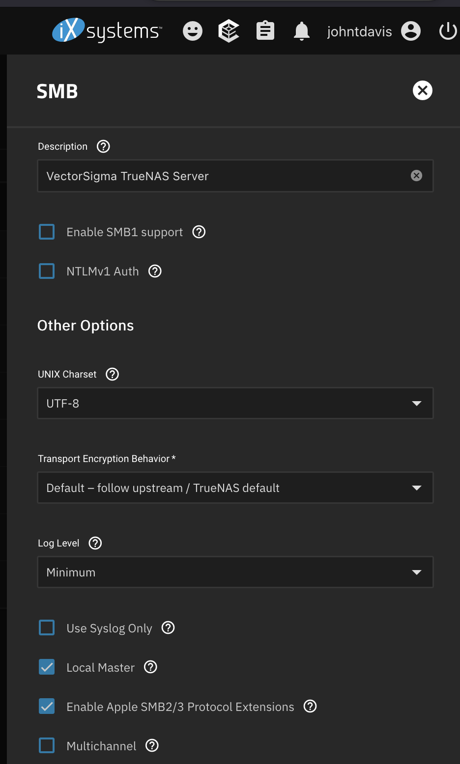

  2. Provide a checkbox to enable this at the SMB service-level in the advanced options. The Advanced Options already contain a couple of Mac-specific options. This could be added alongside them. See the attached screenshot for reference.

Adjusting the default or even adding a more visible Advanced Setting will improve the SMB experience for every Mac user using SMB to manage data across more than one dataset/SMB share.
