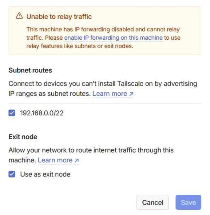

I’m trying to set this up so I can access my Plex server and when I enable the checkbox in the deployed app it doesn’t seem to have any affect as the option in the Tailscale website never lets me check it.
Curious if anyone has a solution to this as I’m getting the below when I try and add either routes or exit node ability? If forwarding is enabled by default as noted above this shouldn’t be generating an error as shown.

I discovered on my Tailnet configuration page that I am still getting the ‘Unable to relay traffic’ despite not having any problems using TrueNAS as an exit route for all my devices. It has been reported on Github In short its a UI Bug unless you are having any issues.
Just updated to Fangtooth and the warning sign has disappeared from Tailscale.
