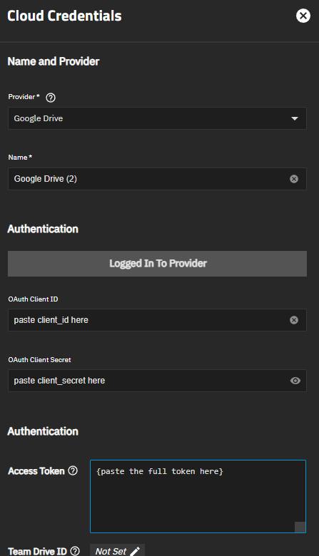

note those down. after this, create a new google drive credential but instead of clicking the authorize button you just fill in the info manually.
you need client_id, client_secret and the full token field (from { until }) and just paste them in. save the new credentials and use them in your existing google drive task.
step by step (after you got your credentials from the shell):
credentials → backup credentials
cloud credentials → add
select Google Drive from the dropdown
click on “configure manually” below “Login to Provider”
paste values as shown in screenshot
