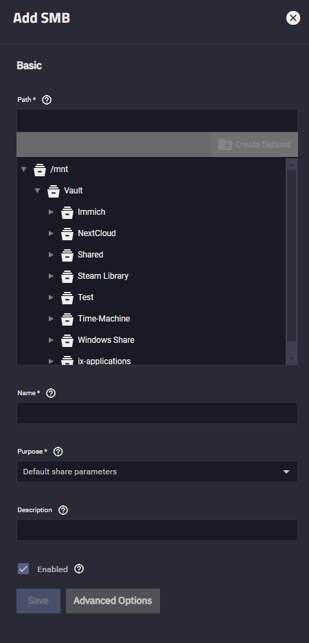

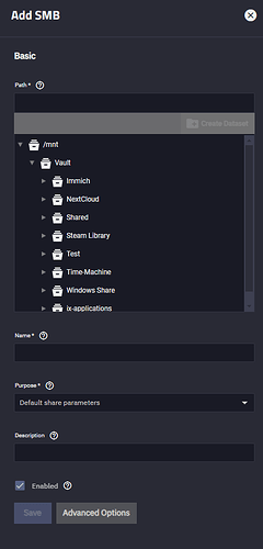

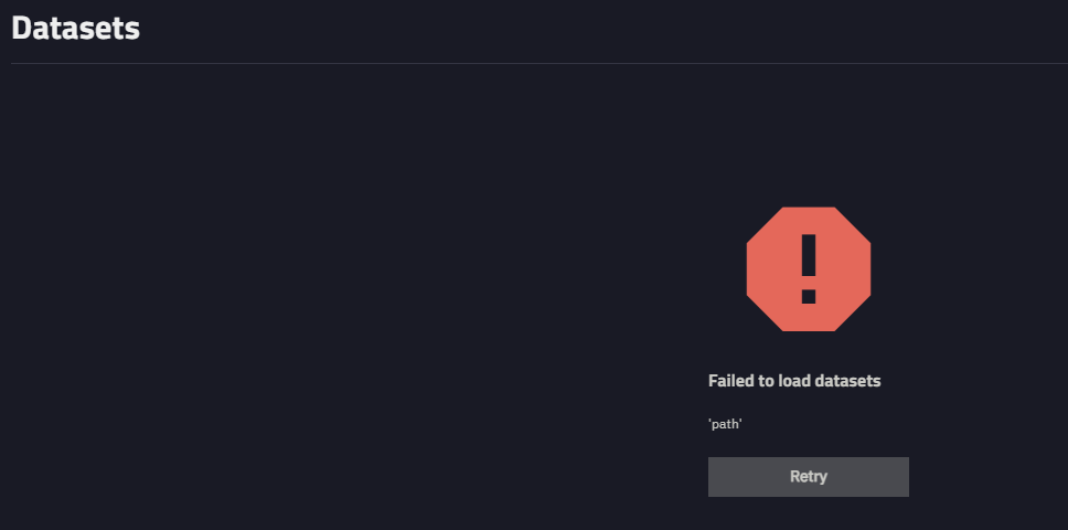

I recently had to recover my boot drive and uploaded my old config to the latest version on TrueNAS Scale 24.10.1. I can see my datasets when creating a share, but can’t manage them via Datasets UI tab. I get the following error.
