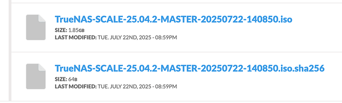

Has anyone been able to create a VM using the nightly?
I downloaded the TrueNAS nightly 25.04.2-MASTER-20250720-234152 to test the return of classic VMs; however, the VM creation fails with the following error.
[EINVAL] vm_create.enable_secure_boot: Extra inputs are not permitted
More info
  File "/usr/lib/python3/dist-packages/middlewared/api/base/server/ws_handler/rpc.py", line 323, in process_method_call
    result = await method.call(app, params)
  File "/usr/lib/python3/dist-packages/middlewared/api/base/server/method.py", line 40, in call
    result = await self.middleware.call_with_audit(self.name, self.serviceobj, methodobj, params, app)
  File "/usr/lib/python3/dist-packages/middlewared/main.py", line 906, in call_with_audit
    result = await self._call(method, serviceobj, methodobj, params, app=app,
  File "/usr/lib/python3/dist-packages/middlewared/main.py", line 715, in _call
  File "/usr/lib/python3/dist-packages/middlewared/service/crud_service.py", line 256, in create
    return await self.middleware._call(
  File "/usr/lib/python3/dist-packages/middlewared/service/crud_service.py", line 287, in nf
    rv = await func(*args, **kwargs)
  File "/usr/lib/python3/dist-packages/middlewared/api/base/decorator.py", line 91, in wrapped
    args = list(args[:args_index]) + accept_params(accepts, args[args_index:])
  File "/usr/lib/python3/dist-packages/middlewared/api/base/handler/accept.py", line 23, in accept_params
    dump = validate_model(model, args_as_dict, exclude_unset=exclude_unset, expose_secrets=expose_secrets)
  File "/usr/lib/python3/dist-packages/middlewared/api/base/handler/accept.py", line 80, in validate_model
    raise verrors from None
middlewared.service_exception.ValidationErrors: [EINVAL] vm_create.enable_secure_boot: Extra inputs are not permitted
I am not using secure boot.
Bug report filed: NAS-136817
Fixed in nightly version: 25.04.2-MASTER-20250722-140850 :tada:
From your linked ticket
“Unfortunately 25.04.2 nightlies have this issue and isn’t going to be fixed. You’ll need to either update to 25.10 nightlies or wait for 25.04.2 proper to be released.”
Does this mean we wont be able to create VM’s using VM Classic?
We will, but only in the released 25.04.2 - not in the current nightly build.
Gotcha. I read that wrong…Whew…
I was confused about that. I thought because they said the nightly was in a code freeze, that’s what would be released as 25.04.2
That’s almost true and was my expectation, but there is an unintended difference in the nightly that is not in the 25.04.2 version under test. We are planning to fix.
25.04.2 is in its last QA cycle and will be released next week.
Apologies for the snafu.
I’ve been informed that tonight’s Nightly resolves the issue. Actual 25.04.2 release is a week away.
