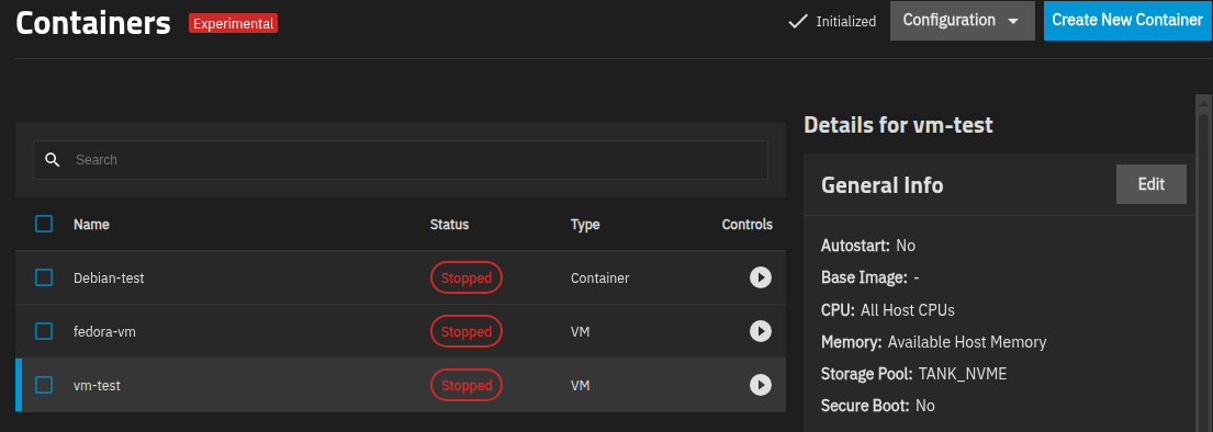

BTW, Incus is still in the system, and – if you are willing to take your chances on what an unsupported approach may mean in the future, and not blame anyone about it – you can still create an Incus style VM from the CLI (use your appropriate pool name for the -s parameter; mine is TANK_NVME):
root@TrueNAS02[~]# incus init vm-test --empty --vm -s TANK_NVME -d root,size=10GiB
Creating vm-test
…which will then show up in the Containers list:
…and from there you can add/configure devices like:
VNC
Disks, including a uploaded ISO-backed, low-priority boot device
etc.
