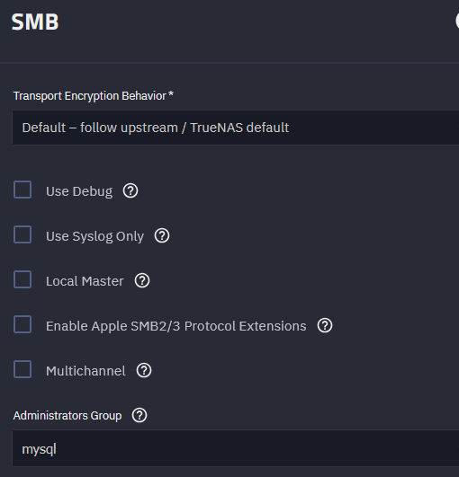

I’ve found that the ‘Administrators Group’ for the SMB Service is ‘mysql’. I don’t know if that is correct or how it happened!
Should it be something else and how can I change it?

I am not sure what you mean here, can you post a screenshot to clear things up?
As requested the image of the admin user on the SMB service.

Okay, that mysql group is peculiar, not sure what to make of that other than that it’s not normal. I don’t think it’s related to your guest access though.
