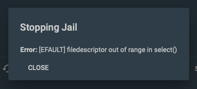

No idea when this was introduced because I am so used to using iocage on the command line, but yesterday:
So apparently you cannot stop and start jails in the UI, anymore, whatever the cause.
Well, time to plan moving on, I guess. We come to it at last … the great battle of our time.

I just logged into the UI and stopped a Jellyfin jail, a Plex jail, and a nginx jail (my reverse proxy). They all stopped without error messages. VNet network interfaces went down and their RAM was released from use. I then started them back up and they came back online with no issue.
When I click on STOP for any jail I get the error message in my first post instead. I thought that much was obvious.

Here’s the full trace from middlewared.log:

[2025/11/17 13:49:07] (ERROR) middlewared.job.run():367 - Job <bound method accepts.<locals>.wrap.<locals>.nf of <middlewared.plugins.jail_freebsd.JailService object at 0x9a373c670>> failed
  File "/usr/local/lib/python3.9/site-packages/middlewared/plugins/jail_freebsd.py", line 1297, in start
    iocage.start(used_ports=[6000] + list(range(1025)))
  File "/usr/local/lib/python3.9/site-packages/iocage_lib/iocage.py", line 1811, in start
    ioc_start.IOCStart(
  File "/usr/local/lib/python3.9/site-packages/iocage_lib/ioc_start.py", line 87, in __init__
    raise e
  File "/usr/local/lib/python3.9/site-packages/iocage_lib/ioc_start.py", line 84, in __init__
    self.__start_jail__()
  File "/usr/local/lib/python3.9/site-packages/iocage_lib/ioc_start.py", line 643, in __start_jail__
    prestart_success, prestart_error = iocage_lib.ioc_common.runscript(
  File "/usr/local/lib/python3.9/site-packages/iocage_lib/ioc_common.py", line 849, in runscript
    output = iocage_lib.ioc_exec.SilentExec(
  File "/usr/local/lib/python3.9/site-packages/iocage_lib/ioc_exec.py", line 268, in __init__
    self.output = list(silent)
  File "/usr/local/lib/python3.9/site-packages/iocage_lib/ioc_exec.py", line 220, in exec_jail
    r = select.select([
ValueError: filedescriptor out of range in select()
  File "/usr/local/lib/python3.9/site-packages/middlewared/job.py", line 355, in run
    await self.future
  File "/usr/local/lib/python3.9/site-packages/middlewared/job.py", line 393, in __run_body
    rv = await self.middleware.run_in_thread(self.method, *([self] + args))
  File "/usr/local/lib/python3.9/site-packages/middlewared/main.py", line 1161, in run_in_thread
    return await self.run_in_executor(self.thread_pool_executor, method, *args, **kwargs)
  File "/usr/local/lib/python3.9/site-packages/middlewared/main.py", line 1158, in run_in_executor
  File "/usr/local/lib/python3.9/concurrent/futures/thread.py", line 58, in run
  File "/usr/local/lib/python3.9/site-packages/middlewared/schema.py", line 985, in nf
    return f(*args, **kwargs)
  File "/usr/local/lib/python3.9/site-packages/middlewared/plugins/jail_freebsd.py", line 1299, in start
    raise CallError(str(e))
middlewared.service_exception.CallError: [EFAULT] filedescriptor out of range in select()

[2025/11/17 13:51:33] (INFO) iocage.callback():71 - * Stopping acme
[2025/11/17 13:51:33] (ERROR) middlewared.job.run():367 - Job <bound method accepts.<locals>.wrap.<locals>.nf of <middlewared.plugins.jail_freebsd.JailService object at 0x9a373c670>> failed
  File "/usr/local/lib/python3.9/site-packages/middlewared/plugins/jail_freebsd.py", line 1316, in stop
    iocage.stop(force=force)
  File "/usr/local/lib/python3.9/site-packages/iocage_lib/iocage.py", line 1843, in stop
    ioc_stop.IOCStop(
  File "/usr/local/lib/python3.9/site-packages/iocage_lib/ioc_stop.py", line 62, in __init__
    raise e
  File "/usr/local/lib/python3.9/site-packages/iocage_lib/ioc_stop.py", line 59, in __init__
    self.__stop_jail__()
  File "/usr/local/lib/python3.9/site-packages/iocage_lib/ioc_stop.py", line 114, in __stop_jail__
    prestop_success, prestop_error = iocage_lib.ioc_common.runscript(
    r = select.select([
    await self.future
  File "/usr/local/lib/python3.9/site-packages/middlewared/plugins/jail_freebsd.py", line 1318, in stop

I moved all virtual machines off of my TN CORE, because while bhybe is well alive and kicking (we had a great bhyvecon in Zagreb this September) the state in TN CORE leaves a bit to be desired.
But I am not going to give up my jails any time soon.
The number I see with that simple fstat | grep is slowly increasing, by the way. 225 > 250 > 252 > …
Interesting. After having my Core server running for a while, it’s still only at 228. The difference is I only use the command-line with iocage to start, stop, exec, and enter jails.
It’s settled for now:
freenas# fstat | grep python3.9 | wc -l
     251
So I guess I will shrug it off for the moment and should the problem in the UI resurface immediately check the open files.
I will have to further investigate alternatives to CORE, anyway, though. Yes, apps and VMs are all fun on CE and I actually use it as an application server.
But I want e.g. my Nextcloud in a jail where I can ssh into and look at the moving parts. And add or modify things. And update at my pace and not depend on an app repository.
Thanks for helping, @awalkerix
Issue is in upstream master. That’s generally the problem with select. It’s basically a ticking timebomb. It works until it doesn’t, and when it fails it can fail bad.
That said, if I were deploying a vanilla FreeBSD server, iocage would not be my first choice for jail managment. I think there are much better libs / tools available these days.
