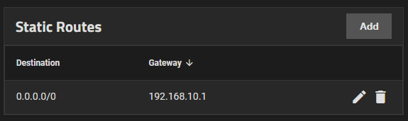

I also tried creating a static router: 0.0.0.0/0 192.168.10.1

What does the Network tab look like? shows interfaces, global configuration and static routes on my Nightly version of TrueNAS. I don’t know if yours is the same.

The Network tab show all the setting posted on the prints all togther no change there.

As soon as i configure static routing on TrueNas the same issue will happen, all outgoing traffic from TrueNas will not work but acessing web interface and ping the static IP of TrueNas works like a charm.
