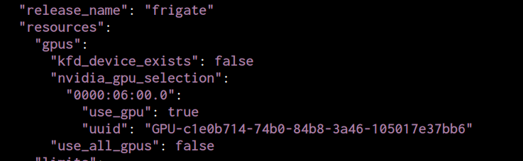

After a NAS restart I’ve activated it on System → Advanced Settings: Enable NVIDIA GPU Support: Enabled
Next, edit the Frigate configuration ans select: Use this GPU

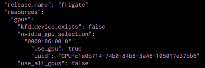

Everything was OK and the Graphic card Is now recognized by the system.
Next I’ve followed this instructions to enable the Graphic Card GPU on Frigate yaml config:

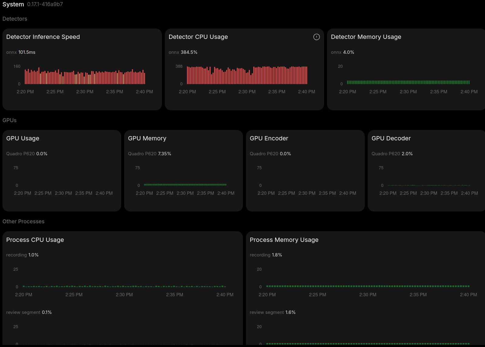

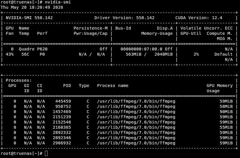

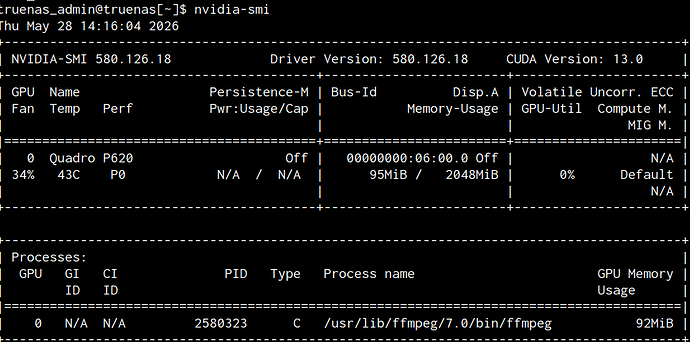

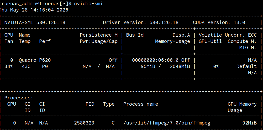

Frigate starts without errors but GPU is always zero:
Command nvidia-smi:

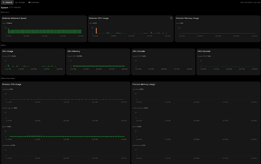

I’m running TrueNAS CE v25.04.2.6 (so I have not used that zzzhouuu Nvidia graphics workaround) and I’m also using an Nvidia P620 in an HP Proliant Gen8 microserver. This is what my metrics look like:
which shows similarly very low usage.
My nvidia-smi says
with nine processes being used, one per camera.

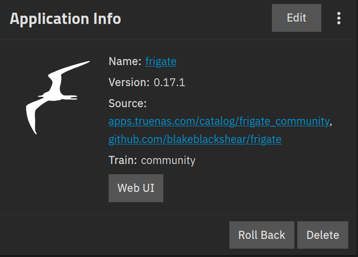

Hi. I’m using the version form APP.
I think it’s the same as yours:

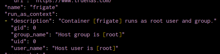

The yolov9-t-320.onnx file had this permissions:
but the Logs show that file yolov9-t-320.onnx was loaded.
Just to be sure I change it to:
The Logs show again that file yolov9-t-320.onnx is loaded:

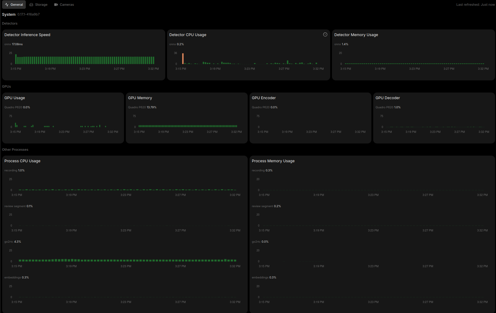

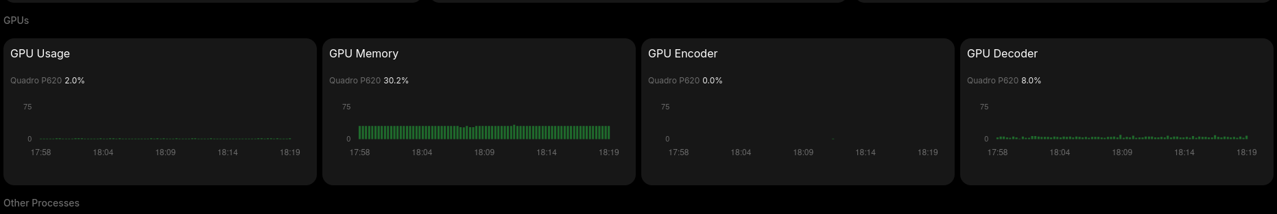

The problem persists.
I don’t understand why the GPU Memory and the GPU Decoder have values but GPU Usage and GPU Encoder not.

Because this is installed as a APP the GPU selection is in the App settings:
Then I search here for the GPU info:
/mnt/.ix-apps/app_configs/frigate/metadata.yaml
/mnt/.ix-apps/app_configs/[app]/versions/1.3.8/user_config.yaml
The APP is running with root permissions:
I’ve changed some settings like:
detectors:
  onnx_0:
    type: onnx
  onnx_1:
    type: onnx
On graphics they are showed but the GPU Usage still 0%.

The Frigate Bot says that NVIDIA GPU cant work with this image, it needs:
Docker image with the -tensorrt suffix, for example ghcr.io/blakeblackshear/frigate:stable-tensorrt
I’ve created a new yaml file with Truenas:
It works very well and finally it’s using GPU!
