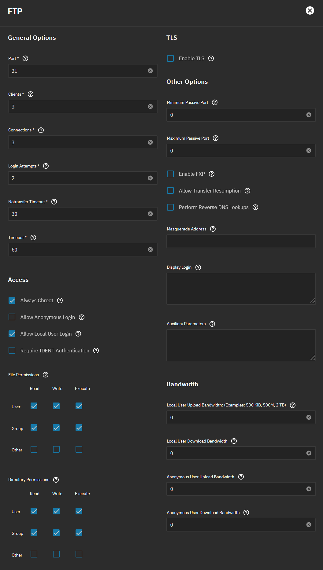

Below the scale exact ftp setup

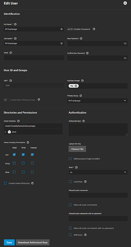

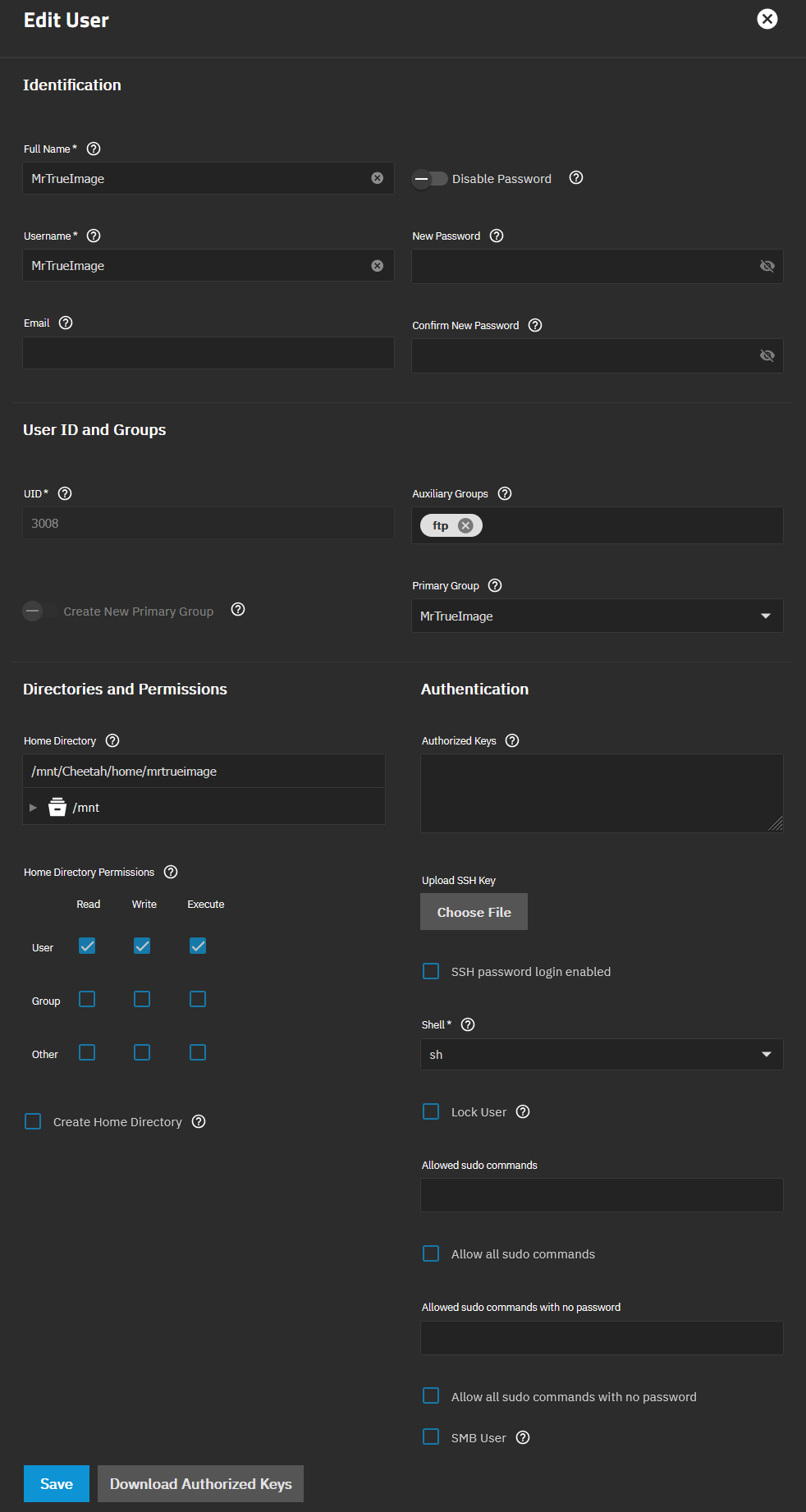

And that of user MrTrueImage (being TrueImage)

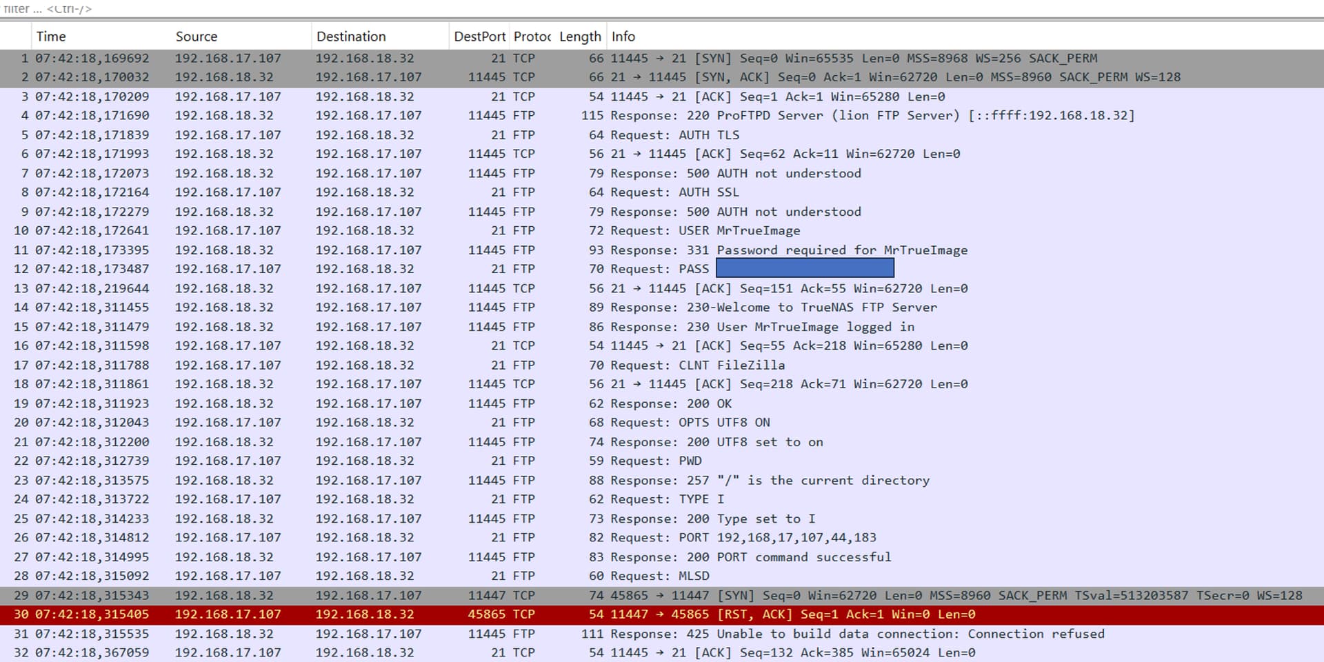

I did make a capture from what is happening in the GreenZone VLAN (below)
The bottum lines show:
  • PC sends MLSD
  • NAS sends some response with a message I do not understand (below)
  • PC sends some response on that
  • NAS sends Unable to build connection
FTP uses multiple TCP connections. What you are seeing in your traffic dump is the control connection (port 21). All data transfer is done with a separate TCP connection (this includes the list of directory contents).
In active mode, which is the case in your screenshot, the server is the one which must open the data connection. The client tells the server “use 192.168.17.107 port 11447 as the destination for the data connection” (that is done via the PORT command). The server tries to establish a connection (The SYN packet, in dark gray) but gets rejected (TCP RST in red).
My guess is that you have a firewall rule that only allows traffic on TCP port 21.
Here’s how I setup my FTP server
  1. Choose a random port for “Minimum Passive Port” (Example: 21000)
  2. Calculate “Maximum Passive Port” as “Minimum Passive Port” + 100 (Example: 21100)
  3. Enter “Minimum Passive Port” and “Maximum Passive Port” in TrueNAS FTP Server settings.
  4. Add Firewall Rule: Protocol: TCP, SRC: [Client IP Range] DST: [FTP Server IP] Port range: 21000-21100
Always use passive mode on the client with this setup. Also if a NAT is in use you need to set the “Masquerade Address” setting (doesn’t seem to be necessary in your case).
