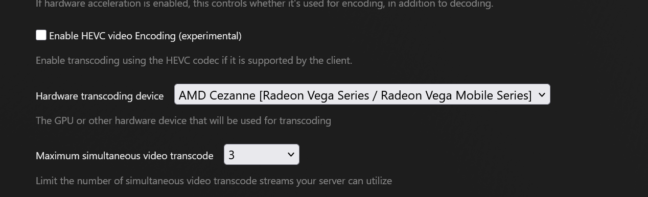

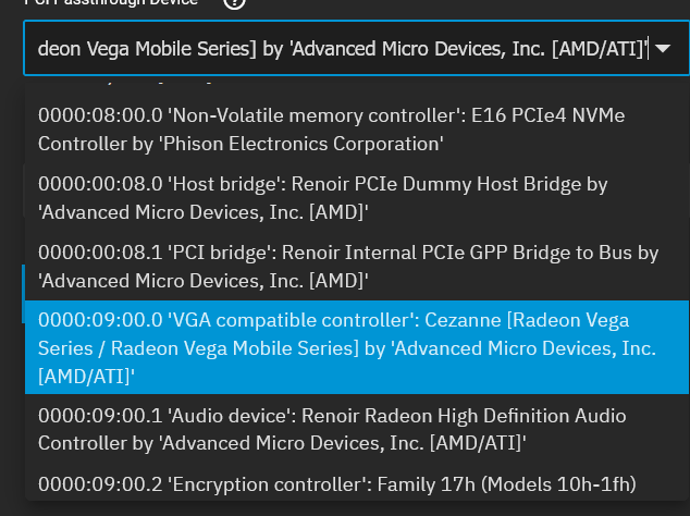

              out of curiosity i just tested my ryzen 5 pro 5650g iGPU, passed through without single warning or error in logs. Passed GPU without audio.
Running on asrock B550 uATX motherboard.
It’s a £36 price difference between 4650g and 5650g worth considering an upgrade?

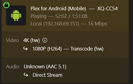

Plex happily uses it for transcoding and it’s faster than quadro p400. Nearly instant playback vs 3-10 seconds delay on p400.

I get this error while trying to passthrough my GPU:
[EINVAL] device.GPU.gpu_type: Field required
If I add the GPU, Multimedia device and audio device as single passthrough devices, I can start the vm but then it hangs during boot.
I get the following messages during boot and the forced stop afterwards:
