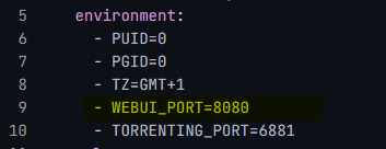

You have to add the uid/gid to the docker-compose yaml file to specify which user/group you want to run as. They go in the “environment:” section as “PUID” and “PGID”. I have a post here that explains how to set it up with Glutun:

The yaml compose from the guide already has the web GUI port in it:
That error suggests that you have a conflict, so either the yaml has two port settings or you have something else on that port conflicting. - or you set the network mode incorrectly
Network mode should only be for routing external traffic so just needs:
    network_mode: container:gluetun
