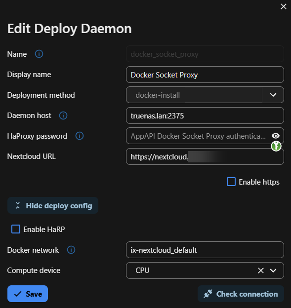

4. Register Daemon in Nextcloud AppAPI
Host: docker-socket-proxy:2375.
Network: ix-nextcloud_default.

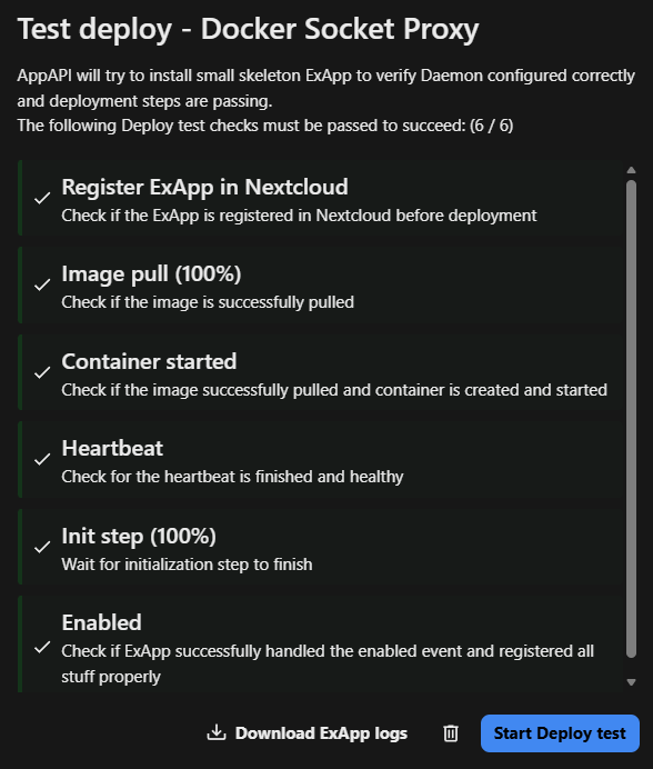

Hey, thanks for the guide! This gets rid of the nasty Deploy Daemon error in Overview.
I followed your instructions, but I tried to skip the manual network connection step. Seemed like too much trouble just for the sake of the hostname. This works for me as well:
  • Template: Docker Socket Proxy
  • Host: nc-docker-socket-proxy:2375 ← no http:// prefix!
  • Network: ix-nextcloud_default
  • Enable HTTPS: OFF
  • Enable HaRP: OFF
:warning: Important gotcha: When you click “Check connection”, AppAPI spins up a temporary nc_app_test-deploy container. This container also needs to be in the right network. Since the socket-proxy is now in ix-nextcloud_default, and test-deploy also starts in ix-nextcloud_default, it should work automatically.

1. Host field must NOT include http://
In the AppAPI daemon registration, the Host field expects only:
Not http://nc-docker-socket-proxy:2375. AppAPI adds the protocol itself based on the Protocol field.

5. AppAPI daemon network setting
Set the Docker network in the daemon config to:
ix-nextcloud_ix-internal-nextcloud-net
