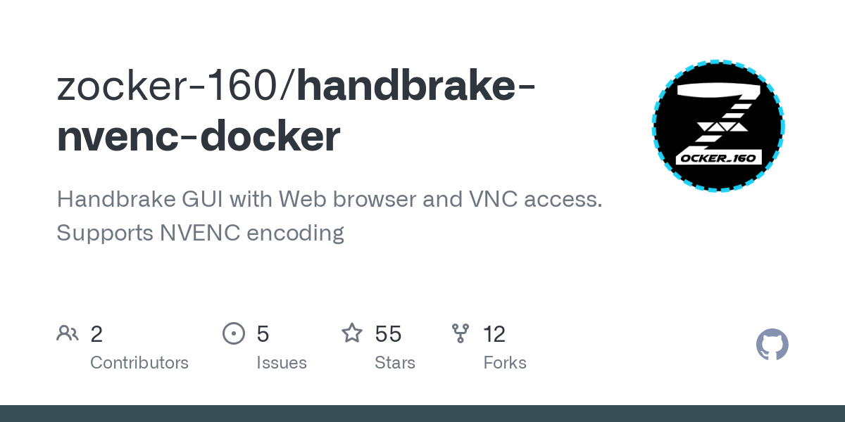

So it appears the Handbrake container it is pulling from has no NVENC encoders.
See: NVENC disabled/ not supported anymore? · Issue #351 · jlesage/docker-handbrake · GitHub
Here is a fork of the project with NVENC — but I will admit I don’t know how to install it or add it to the repository for TrueNAS
